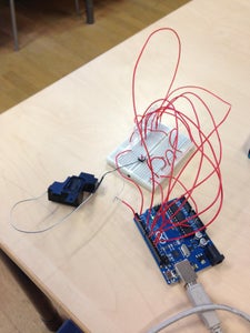

Step 1: Connect the Arduino and Make the Speaker Play
This is how i connected the arduino to the white connection plate.
With these picture should help you get an ide of how to connect the speaker to the arduino plate and make it play the basic melody that you will find in the arduinio program on you pc.
Check out http://arduino.cc/en/Tutorial/Tone if you need more info on how to connect.
