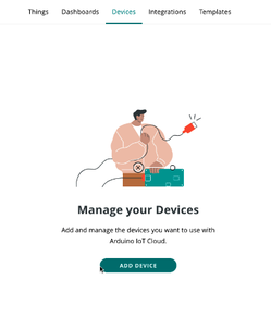

Step 2: Connect Device
  • Click on the Devices tab and connect your device to the IoT cloud

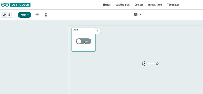

Step 5: Make a Dashbord
  • On the Dashboard tab add a switch
  • Link the switch to the blueLED variable
  • TEST
  • Click the switch
  • You can download the Arduino Dashboard app from the Android or iPhone stores to control remotely
