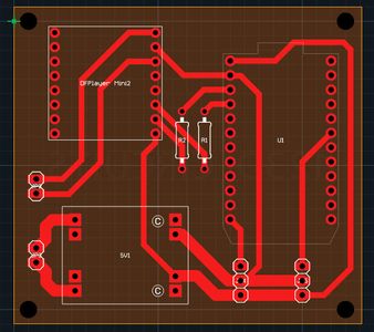

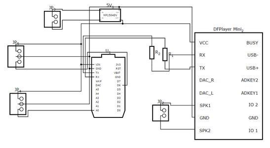

Step 1: Building the Circuit for an Internet Connected Arcade Clock
In the first video I walk through the process of designing and building the circuit aka "the hardware" for an internet connected rgb matrix arcade clock! I talk about the components we will use as well as designing the circuit using Circuits.io free online editor.
Attached are the .nc(grbl) files that you can use directly on your cnc machine.
For the highest quality, the order in which the circuit board is milled is important.
Below identifies the tool and sequence of each of the four milling operations.
CNC tooling and Milling the four GRBL files:
  1. First, use a #64 / 0.036" drill for the pin holes.
  2. Next, use a 0.128" drill for the mount holes
  3. Next, use a 0.015" two flute altin coated stub endmill to mill the circuit board.
  4. Finally, use a 1/8" / 0.125" 4 flute flat endmill to cut out the board.
Below is a link to the circuit design that is available online.
Circuits.io Schematic: https://circuits.io/circuits/2962119-8bitclock
