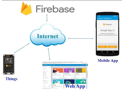

Step 3: Configuring Firebase for Real-time Communication
In this step, we'll guide you through the process of setting up a Firebase account, creating a database, and configuring it for real-time communication with your Arduino Nano 33 IoT. Firebase is a powerful platform for real-time data storage and synchronization, making it ideal for IoT projects.
1. Create a Firebase Account:
If you don't already have one, start by creating a Firebase account at Firebase. Sign in using your Google account and follow the setup instructions.
2. Create a Firebase Project:

5. Integrate Firebase in Your Project:
To enable communication between your website and your Arduino Nano, you'll need to integrate Firebase into both. Here are basic code examples for initializing Firebase in your website's JavaScript:
<!-- Add Firebase scripts to your web app project -->
<script src="https://www.gstatic.com/firebasejs/8.2.10/firebase-app.js"></script>
<script src="https://www.gstatic.com/firebasejs/8.2.10/firebase-database.js"></script>
<script>
 const firebaseConfig = {
  apiKey: "your-api-key",
  authDomain: "your-auth-domain",
  databaseURL: "your-database-url",
  projectId: "your-project-id",
  storageBucket: "your-storage-bucket",
  messagingSenderId: "your-messaging-sender-id",
  appId: "your-app-id",
  measurementId: "your-measurement-id"
 // Initialize Firebase
 firebase.initializeApp(firebaseConfig);
</script>
Replace the placeholders with your actual Firebase configuration details.

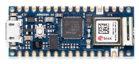

6. Firebase Integration in Arduino:
For your Arduino Nano 33 IoT to communicate with Firebase, you'll need to include Firebase libraries in your Arduino sketch. You can find these libraries in the Arduino Library Manager. After installing the libraries, you can use the Firebase API to read and write data in real-timeHere's a basic example of how to read data from Firebase using Arduino:
#include <Arduino.h>
#include <FirebaseESP8266.h>
#define FIREBASE_HOST "your-firebase-host.firebaseio.com"
#define FIREBASE_AUTH "your-firebase-auth"
FirebaseData firebaseData;
void setup() {
  Serial.begin(115200);
  delay(1000);
  Firebase.begin(FIREBASE_HOST, FIREBASE_AUTH);
  if (!Firebase.beginStream(firebaseData, "/your/firebase/path")) {
    Serial.println("Could not begin stream.");
void loop() {
  if (Firebase.readStream(firebaseData)) {
    Serial.println("Data: " + firebaseData.dataPath() + " - " + firebaseData.stringData());
Make sure to replace "your-firebase-host", "your-firebase-auth", and "/your/firebase/path" with your Firebase project details.
By following these steps, you'll have Firebase set up for real-time communication between your website and your Arduino Nano 33 IoT, enabling data synchronization and interaction with your product dispensing machine.
Step 4: Programming the Arduino Nano 33 IoT
In this step, we'll guide you through programming the Arduino Nano 33 IoT to interact with your website, read data from Firebase, and respond to payment confirmations. You can use the provided starter code for Firebase integration as a basis. Additionally, we'll provide a clear wiring diagram for connecting the Arduino to the vending machine components.
Starter program for Arduino Nano 33 IoT:
#include <WiFiNINA.h>
#include <Firebase_Arduino_WiFiNINA.h>
#define FIREBASE_HOST "your-firebase-url.firebaseio.com" // Replace with your Firebase database URL
#define FIREBASE_AUTH "your-firebase-auth-token"         // Replace with your Firebase authentication token
#define WIFI_SSID "your-wifi-ssid"
#define WIFI_PASSWORD "your-wifi-password"
void setup() {
  Serial.begin(9600);
  while (!Serial);
  // Connect to Wi-Fi
  WiFi.begin(WIFI_SSID, WIFI_PASSWORD);
  while (WiFi.status() != WL_CONNECTED) {
    delay(1000);
    Serial.println("Connecting to WiFi...");
  Serial.println("Connected to WiFi");
  Firebase.begin(FIREBASE_HOST, FIREBASE_AUTH, WIFI_SSID, WIFI_PASSWORD);
  pinMode(LED_BUILTIN, OUTPUT);
  digitalWrite(LED_BUILTIN, LOW);
void loop() {
  if (Firebase.getInt(firebaseData, "/paymentStatus")) {
    // Payment confirmed, take action (e.g., dispense product)
    Serial.println("Payment confirmed, dispensing product...");
    digitalWrite(LED_BUILTIN, HIGH); // Turn on an LED as an example
    // You can add your custom actions here
    // For example, controlling a motor to dispense a product
  } else {
    Serial.println("Waiting for payment confirmation...");
    digitalWrite(LED_BUILTIN, LOW); // Turn off the LED
  delay(1000);
