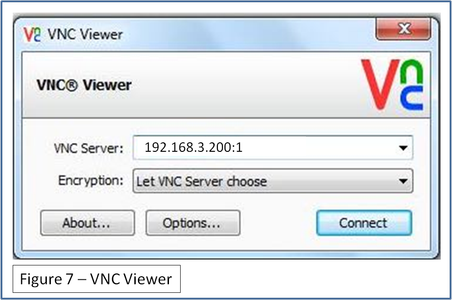

Step 4: Install VNC Viewer on Laptop (Client Side)
Download VNC client from [5] and install it. At first run of VNC Viewer, Figure 7 will appear, but you'll have to put in your RasPi IP address in the space for VNC Server:. Click connect and enter the 8-digit password that you used to create the VNC Server. Append password with :1. This denotes port number, then press Connect. Figure 8... don't forget the user name which may be pi. Click OK. You will get a warning message, press ‘Continue’:
Finally, the RasPi desktop GUI itself should appear as a VNC window as in Figure 5. You will be able to access the GUI and do everything, as if you were using the RasPi’s keyboard, mouse and monitor directly. As with SSH, since this is working over your network, your RasPi could be situated anywhere as long as it is connected to your network.
