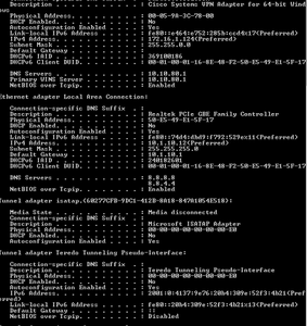

Open a command prompt. You can do this by Start>Run and typing CMD and hitting Enter. In Windows 7 do this in the search bar in the Start menu.
Type ipconfig /all and hit Enter. You'll see something like this. (A portion was omitted for privacy but the important part is there).
That's a whole lot of info. You may see less or perhaps more. What I'm looking for is an Ethernet Local Area Connection. There are two pieces of information that are crucial.
(Note: If you see a subnet other than 255.255.255.0 find a “Subnet Calculator” to determine your network range)
Check out http://media.packetlife.net/media/library/7/IPv4_Multicast.pdf for a sweet IPv4 cheat sheet!
* Subnet Mask: 255.255.255.0
* Default Gateway: 10.1.10.1
Now, you know that your LAN is running on 10.1.10.0/24. Without getting in-depth, this tells you that any IP address between 10.1.10.1 and 10.1.10.254 is a useable address. You'll likely see different addresses here, but the important part is going to be the first three octets of the Default Gateway.

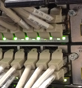

Label cable ends. On each end of a cable I attach a label of what connects to it and where. In a switch it looks like this picture - my new switches (at work), and do the opposite on the other ends. Nothing fancy needed, masking tape and a ball point will work just fine.
Make a Switch-port map and network diagram. Just make a spreadsheet of which port connects to what. Draw out your network with what connects to what and how. I swear it will help in the future when you try to put everything back together after moving a desk.

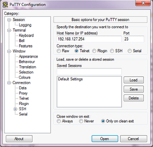

Now we need to telnet into the device and give it an IP that will work on our LAN. Go to Start>Search(or Run)> type cmd and hit Enter. Download PuTTY. Newer Windows version may or may not have Telnet or Hyperterminal installed, and PuTTY is pretty good. It should look like Image 2. Click Open.
When connected set the network parameters you selected previously.

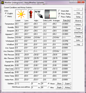

Step 7: Software Configuration
Software Configuration:
Note that most of the software configuration will vary greatly from each device.

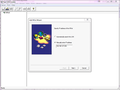

* Download the Management Suite and install. This will connect the IP of the Device server to a virtual COM port that other installed software will think is local to the computer. Most devices will come with a COM port virtualization tool. Make sure whatever you buy does.
* Open the Real COM Mapper that was part of the install and follow the Add Server Wizard. (Image 1) I bound COM2 to the IP address of the Device Server.

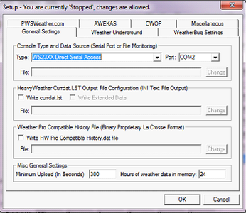

* Download and Install WUHU.
* In the setup screen I did the following and clicked OK (Image 2):
Success! (Image 3)
I chose pretty bland serial settings and hoped that they would work. Looks like they are! (Image 4)

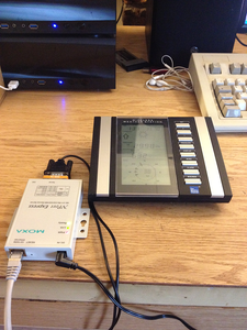

Here's the whole setup in testing and working, now to label and find a dark corner to stash it all
