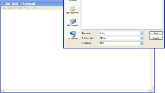

3. Download the attached file "ftp.conf" and place in the "/settings" folder.
4. Create a blank file called "ftp.log" as seen in picture 1 and place it in the "/log" folder. Ensure that "Save as type" is set to All Files.

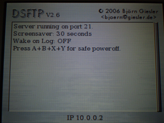

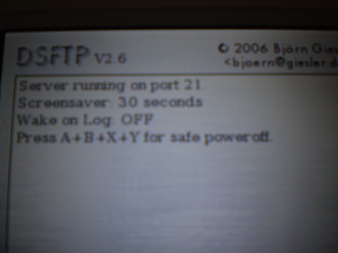

Step 3: Using
Once FileZilla and DSFTP are both fired up. Look at the bottom of your DS's top screen, there will be "IP" then some numbers, the DS' IP address. Type this into "Host" in FileZilla (FZ) and remember the username and password we set before and type that into the username and password fields (duh).
Look on both the DS screen and FZ, you'll see some words popping up everywhere, give it a second and then you'll see a file listing of the memory card on your DS. From here use is pretty simple, Drag stuff from the left side (your computer) to the right (your memory card) and visa versa.
