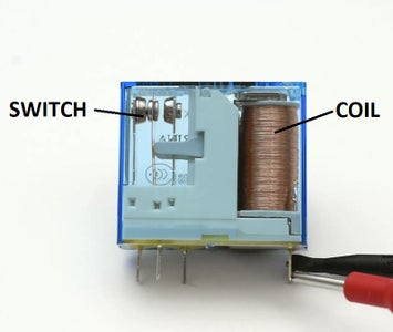

Step 2: Identify 'Coil' and 'Switch' Side of the Relay
The relay in my Bill of Material has two parts - the relay housing and the base - and may come as two individual items. To assemble, insert the housing into the base, the pin configuration on the bottom of the housing will only fit into the base in one way. Your relay may not look exactly like this but you should be able to identify the 'Coil' side and 'Switch' side using this picture as a reference.
