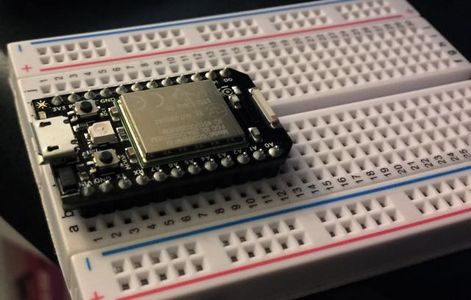

The first step is to part the device into listening mode. There are a couple ways this can be done.

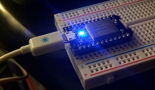

Step 1: Listen Mode
The default first step is to put the device into "Listen Mode".
The sign that this has been completed is an illuminated blue LED in the center of your Spark Core.
At this point it is time to connect your device to WiFi.

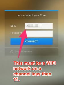

  1. From either Apple or Google app stores download the Spark application.
  2. Open the application and you will be prompted with two dialog boxes.
You will need the SID (Wireless name) and password of the network you want to connect the Spark too.
After you have filled out both items hit the "Connect" button and watch for the colored LED on the core to change, if after a minute or two the LED has not changed or the application times-out double check:
  • The WiFi password you entered is correct
  • Your device is on the same WiFi that you are going to use for the Spark.
  • Your Wifi uses an access frequency channel that is lower then 11.

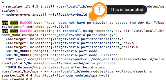

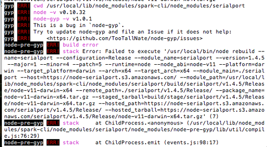

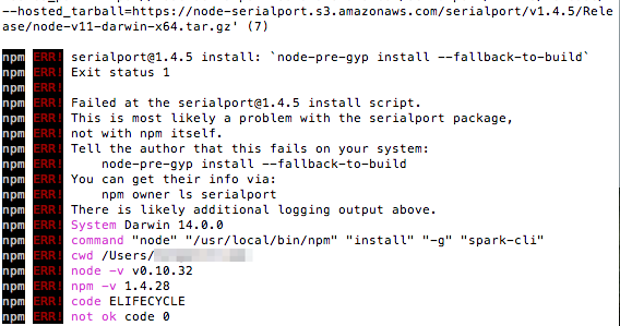

  1. Prior to installing the software to communicate with the Spark you must have Node.js installed. (I found the version for the MAC installed via Home Brew did not seem to work cleanly).
Once you have confirmed that Node is installed, run the command:

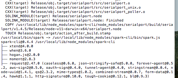

sudo npm install -g spark-cli
While you will see the error as noted the command should still complete successfully. If you see anything other then warnings (as seen in the attached screen captures), retry your command.

Step 4: WiFi Connection - Medium Way Step 2
Once the command line installer (via Node) has completed, you should see something ver close to the screenshot above.

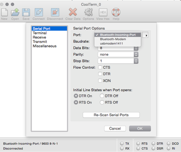

  1. Download / Install a Serial USB emulator, I recommend Cool Edit (there should be no special drivers).
  2. Open a standard terminal Window once installed open a Terminal window and issue the command:
ls /dev/cu.*
This should yield items in your directory that begin with "cu" in the name. The Spark will be named something similar to cuXXX.umodem. (Ex: /dev/cu.usbmodem1411)
Connect to this device in the next step.

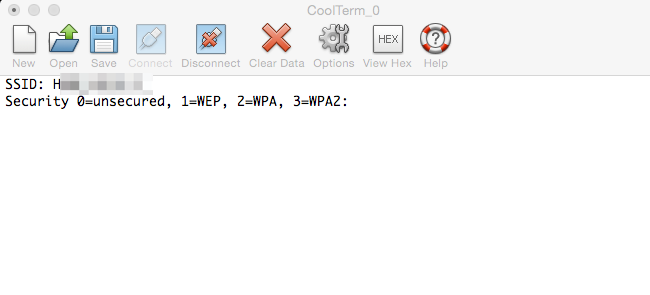

Step 6: WiFi Connection (The Hard Way - Step 2)
In your terminal application select the device you want to connect and confirm you are setup to 9600 N-8-1 (eight (8) data bits, no (N) parity bit, and one (1) stop bit).
Step 7: WiFi Connection - (The Hard Way Step 3)
Once you are connected to the device, select W first to configure the wireless settings and fill in the information as prompted.
  1. Enter your SSID (must be on a lower channel then 11).
  2. Enter your security type (WEP, WPA, WPA2)
  3. Followed by your password

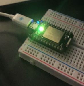

The Spark application will attempt a connection turning the LED light to green while saving and validating the WiFi connection and then to a cyan with a slow flash to show it is connected.

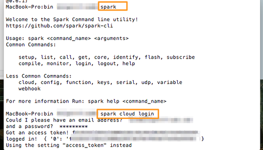

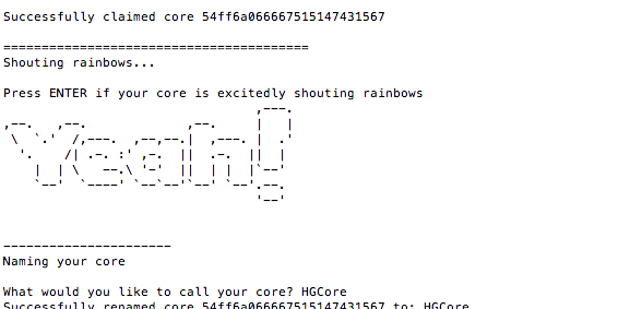

Step 8: Login to Your Spark
At this point you should be able to type spark at the command line and have the command options returned to you.
If this works you can login by entering spark cloud login which should allow you to login and control your device.
And if the 3 other ways to set up your wireless did not work your final shot is here by typing spark setup which should prompt you for the same items as you did with the serial connection.
Step 9: Finally - SHOUTING RAINBOWS
At this point you should be setup, logged in an "shouting rainbows" (multi color LED) from your core.
