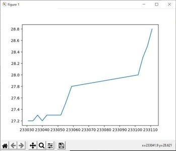

Step 4: Plotting Temperature and Humidity Change
In this final step, using the log file that we created in the previous step, we'll plot the temperature and humidity change over time. In order to plot temperature, you need to set the line y = matrix_data[:,6] . In order to plot humidity, you need to set the line y = matrix_data[:,-2] (6 and -2 correspond to the colums representing temperature and humidity values respectively, you can check for the text file, first column having the indice 0)
Code:
import numpy as np
import sys
import matplotlib.pyplot as plt
np.set_printoptions(threshold=sys.maxsize)
read_file=input('Please enter file name to read: ')
test2_file=open(read_file, 'r', encoding = 'utf-8')
matrix_data = np.genfromtxt(test2_file)
x = matrix_data[:,3]
plt.plot(x,y)
plt.show()
