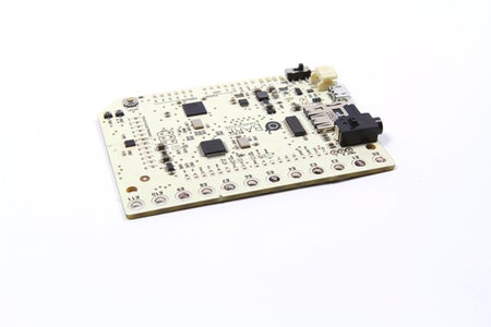

Step 1: 12 Contact Points
The Touch Board has 12 contact points running along the top side of the board. We lined them all up like this to make it easy for you to connect the board to different things while it could sit discretely on the edge. We have been working with the manufacturers to get the maximum surface area for these points to ensure good electrical connection to a variety of different materials so in the final version these should be a little bigger.

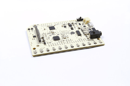

Step 2: 12 Contact Point Headers
The 12 contact points running along the top edge are replicated in a strip of points on the side of the Touch Board (on the left in this picture). These can have headers soldered onto them so you can connect to the Touch Board in this way too or solder what you want to connect directly to them.

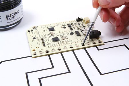

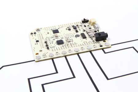

Step 3: Cold Soldering With Electric Paint
In our video, we stencilled on all our graphics on paper using our Electric Paint if you want to see how we did this check out our Instructable about Stencilling. We made the Touch Board flat on the back so it can lie flat on paper or a surface painted with Electric Paint. To ensure a good electrical contact you can cold solder the board to the painted surface with an extra blob of Electric Paint in the holes of the touch points, you might want to also stick the board down with double sided tape to make sure it stays in place.

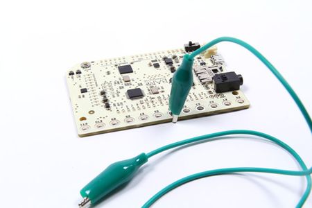

Step 5: Crocodile Clips
An even quicker way to connect is to use crocodile clips.

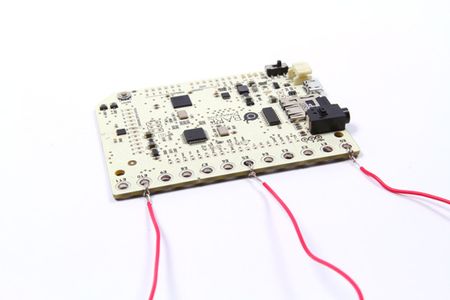

Step 6: Wrap Wire Around the Touch Points
If you don't have crocodile clips, why not just wrap wire around the touch points for a quick and easy way to connect.

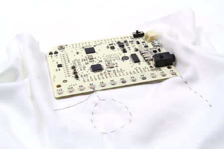

Step 7: Conductive Thread
If your thinking of using it with fabrics or textiles you can sew it into your projects using conductive thread.

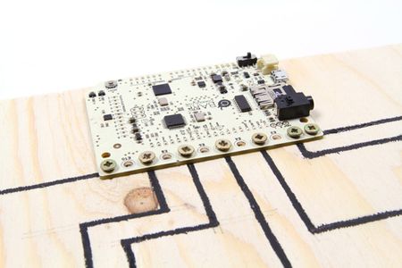

Step 8: Screw It to Wood or Walls
For a more durable connection to harder materials you could try screwing or nailing it to wood or walls.

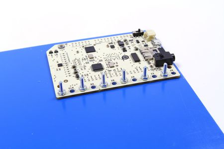

Step 9: Nuts and Bolts
For thinner materials like plastics you could also try tiny nuts and bolts.
