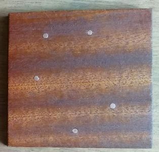

Step 2: Constellations
Find constellations online (eg StarDate’s Constellation Guide) or in a book. When you’re selecting them, bear in mind that they need to fit into a square without any two stars being too close together – constellations with a fairly even distribution of stars look best. I used the Plough (aka Big Dipper, part of Ursa Major and therefore, strictly speaking, an asterism not a constellation), Cassiopeia, Auriga the Charioteer, Lyra and Cancer.
Adjust the size of each constellation to fit on a coaster without any star being closer than about 10mm from an edge or 15mm from another star, to minimise the risk of the wood splitting when the copper inlay is hammered in.
Trace off your re-sized constellations (or just print them from a computer) and transfer them to the coasters, making a pencil mark for each star. Orientate the constellations to avoid more than one star being on the same grainline, especially if they are relatively close to each other, again to minimise the chance of the wood splitting along that grainline.

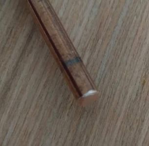

Step 4: Cutting the Inlay
Cut (or saw) a generous length of copper wire off the reel. It needs to be at least 15cm (6”) long, even for just a few stars, or it will be too short to hold when cutting and filing. Straighten it as best you can by hand, or by laying it on a flat surface and hitting it repeatedly along its length with a mallet while you rotate it.
We’re going to cut lengths of wire to whatever length you decided in the previous step was best for the inlay, probably about 1mm longer than the hole depth. The easiest way to do this is with a Dremel fitted with a suitable cutting disk, but you can also use a junior hacksaw or a jeweller’s saw. Clamp the wire between two pieces of scrap wood in the jaws of a vice for sawing (the wood will develop a groove when you close the jaws tightly on the wire the first time, use the same groove each time), or just hold it down against a piece of scrap wood if you’re using a Dremel – but hold it well away from the cutting area, it will get hot!
Mark the length you want to achieve on a piece of paper and use it as a measure to make a pencil mark on the wire for the next length after each cut. It’s easiest to file the end of the wire flat (ordinary file then needle file) and de-burr the circular edge before cutting each length (but after marking it). Don’t bother making it perfectly smooth, you’re going to be hitting it with a hammer shortly.
If you’re using a Dremel to make the cuts, reduce the pressure you’re applying to the minimum when the cut is nearly through and stop as soon as you see the almost-cut-through piece start to bend. Bend it on the workbench to break off the piece you want. This stops short lengths of wire from flying all over the room and getting lost.
Only one end of each piece of wire needs to be flat and clean, but de-burr the other end after cutting and make it approximately flat (remove the high points), holding it in a vice between two pieces of scrap wood as before. Don’t file off too much material, the finished length of each wire needs to be a little longer (say 0.5mm) than the hole depth.

Step 7: Inlaying
Lay a coaster face up on a flat surface that’s covered in something firm that will cushion the wood a little and prevent the underside from being marked, such as a cork mat, a hard piece of rubber or an offcut of plywood.
Place a star in position on the coaster, in one of the holes near the centre – make sure the “good”, shiny end of the wire is upwards – and hammer it into its hole, being careful not to strike the wood. Tap it in quite lightly at first to get it to go in full depth, then harder to squash it in and make it fatten out. When you feel that you are in danger of marking the wood if you hit it again, use a pin punch of the same diameter as a star to drive the copper flush with the surface. (If you don’t have a pin punch of a suitable size, fashion one by cutting the tip off a nail squarely and filing the cut end perfectly smooth. I used a clout nail because it was the right diameter and because they have a large head which makes it easier to hit them squarely.)
Inlay the remaining stars, working outwards from the centre on each coaster.
It’s important to avoid driving the stars below the surface, they won’t look good. But if, despite your practice piece, you find the lengths of copper inlay are too short when you come to use the first one for real, don’t despair. Just pack out the bottom of the star holes with small pieces of hardwood, even pieces cut off a cocktail stick will do. When you drive in the inlay it will compress the wood into the base of the hole and you should be able to get the copper flush with the surface.
The pin punch may raise small burrs on the surface of the copper. Carefully remove them with a needle file held perfectly parallel with the surface of the coaster. Turn the coaster frequently as you’re filing so that, if the file does touch the wood, it’s not all in the same place. Any inlays that are slightly proud of the wood surface can also be made flush by careful filing.
