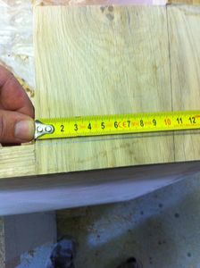

Step 1: Mark Edges
First step is to mark the edges which should be connected by a curve.
In my case I chose to do this "in situ", but the method will be the same if you do this on a sheet of paper. What needs to be found are
- the angle at which two lines intersect
- start and endpoints of the connecting curve on these two lines
Working "in situ" has the advantage that the two lines can be found easily by holding a ruler against the edges and just extending the edge line. The curve enpoints were chosen to lie on the very edges of the plates.

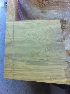

Step 2: Divide
Next is to divide the lines between curve endpoints and intersection into equal pieces. My lines were measured to (roughly ;-) 100 and 130mm so I chose to divide them in 10 equal spaces of 10 and 13mm, respectively.
As you can see on the 2nd picture, the 10th divider of the vertical line isn't "exactly" meeting the intersection with the other edge line due to the fact that the measure was 103mm - a difference I chose to neglect - the error is small enough in practice.
