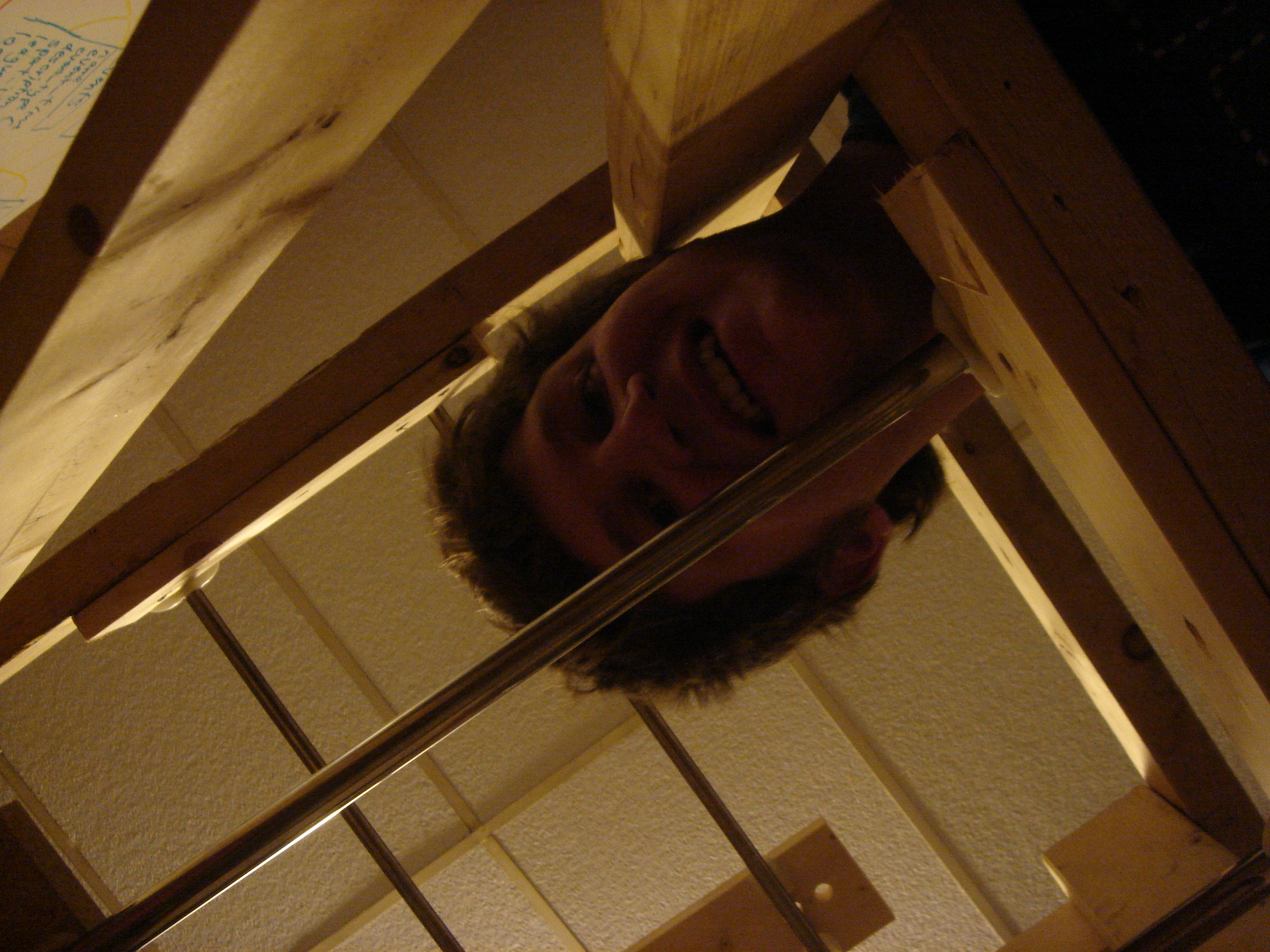

First we cut four boards to length for the vertical posts, then we cut 8 boards for the sides. We essentially just created a box frame. Assemble the side boards into two rectangles, making sure that you keep them square. Next, attach the vertical boards on the inside of each rectangle. Keep making sure that your boards are square... this will really help things out later. Finally attach the second rectangle to the assembly, and you will be nearly done. Once we had it assembled, it was a bit wobbly, so we added diagonal cross bracers. After that it was rock solid and very sturdy.
Next, you will want to mount some boards where you want the YZ stage to go. Mount this about halfway up the frame, as they will protrude below the mount when the Z stage is all the way down. You can always adjust the height once you get the whole thing assembled.
If you want, you can optionally pimp out your lovely box with some wheels to help you move it around. These simply get screwed to the bottom of the posts and definitely give your RepRap some street cred.
Now you have the frame assembled, and its time to create the linear stages!
