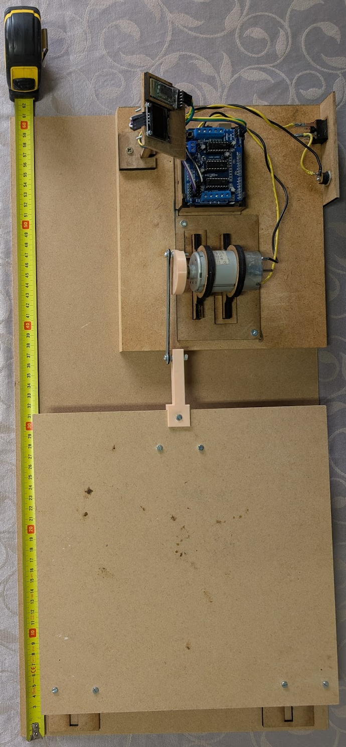

The QuakeScientific project aims to develop a small-scale earthquake simulator that allows users to observe the impact of seismic activity on different structures. The system consists of a physical platform controlled by an Arduino, which generates vibrations to simulate tremors. This project combines mechanical design, electronics, and programming to create an interactive educational tool.
Physical Construction
The simulator’s physical structure is designed using Inkscape, Tinkercad, and SketchUp, where the parts are modeled before being manufactured through laser cutting and 3D printing. Once all components are produced, they are assembled to form the final artifact.

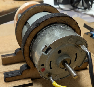

  1. Arduino UNO REV3; 1
  2. DC Motor; 1
  3. L293D Motor Shield x2; 1

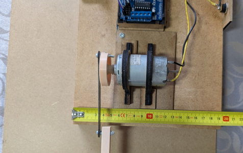

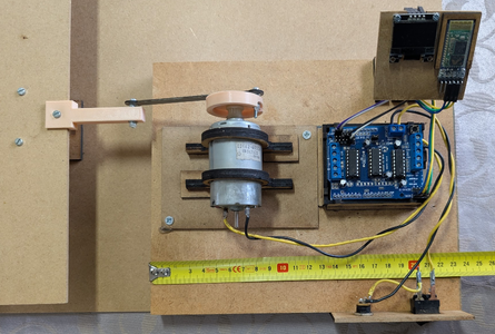

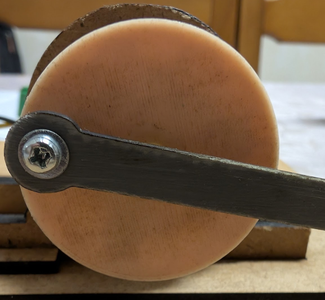

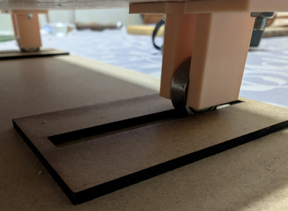

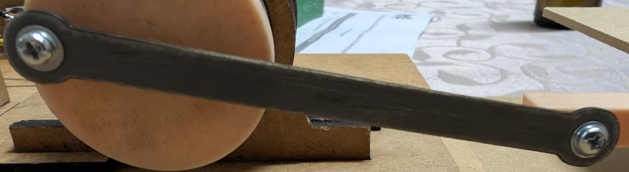

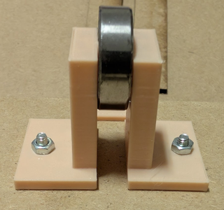

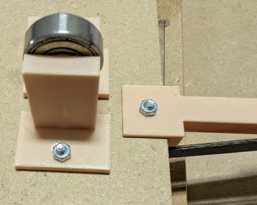

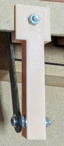

Step 3: Construction
The structure was built using MDF, with some parts designed in Tinkercad 3D. The main concept is to have a platform that slides along a rail from back to front.
