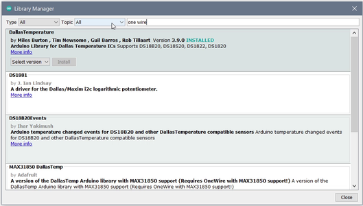

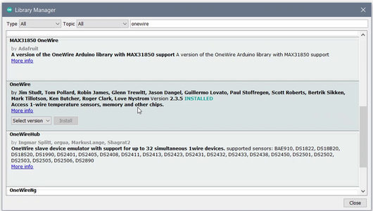

Step 3: Testing DS18B20
Now we can program the Nodemcu, Just go to your Arduino IDE and download the Dallas temperature sensor library and one wire library. Once that’s been installed. Go to example and open the simple temperature sensor example and change the pin wherever the sensor is connected too, in my case it’s pin D2 which is GPIO 4.
Compile and upload the code.
Once, the code is uploaded you can open the serial monitor. You see the sensor data is shown here, but this DS18B20 sensor doesn’t instantly show accurate temperature readings same as commercial thermometers, it takes a while to settle down at the correct value, you can also see how this affects in the final build. So, for the sake of this experiment, I have reduced it to the measurement time to 15 seconds. But in case you need a better accuracy you can always increase the measurement time in the code.

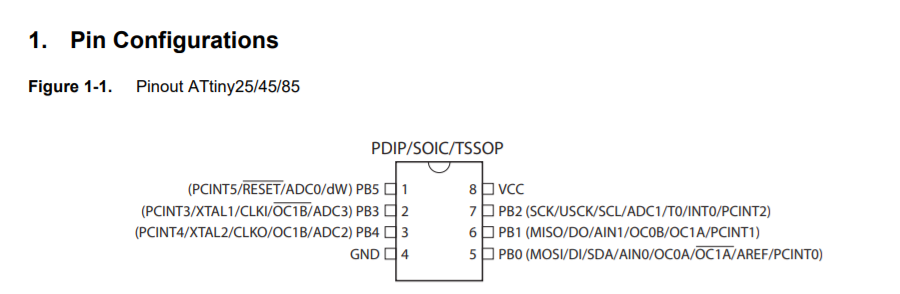

Step 9: ATTINY 85
This is an 8 bit microcontroller with 8 pins and has all the features that we exactly need, a I2C to drive the OLED display, an input pin to read the temperature reading and also analog input to read the piezo reading. Mostly importantly this can do all this while being powered by just a single 3.3v cell.
But it comes with it’s own disadvantages. It's slightly complicated to program, the storage is limited to 8kb and ram is just 512 bytes and also it has just 5 usable pins. We can use the reset pin as GPIO but it just makes things way more complicated than it was initially. So, deciding the microcontroller was purely based on a few simple questions: Is that enough? Can we fit everything in ? Do I have it? Can I program it? In my case, it’s a big YES!

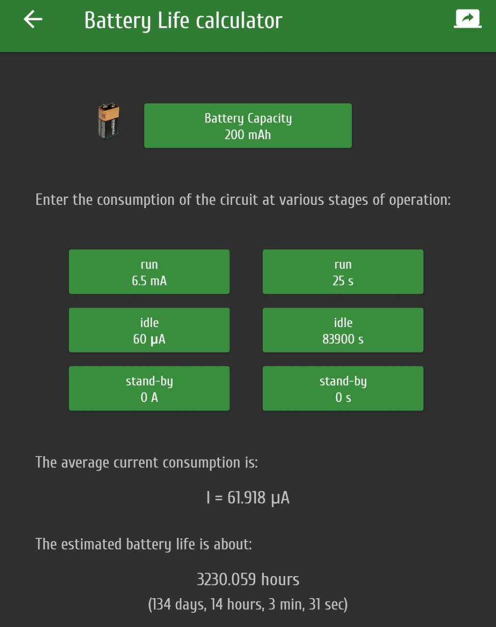

Step 12: Verify Power Consumption of the Circuit
Before diving into using other components with this let’s just verify if the current supplied by this single 3V cell is enough to drive all the components.
So the cell I’m using is CR2032. This cell has a capacity of 210mAh, and a peak current draw of 30 mA. So we have to keep everything under atleast 20mA to work perfectly.
ATTINY 85 needs little less than 4mA [datasheet] running at 3.3V at 8Mhz and the temperature sensor DS18B20 needs 1.5mA [datasheet] while it’s reading the temperature and the oled display needs 20mA [datasheet] when displaying all the pixels on the screen. Combined all this together we are still less than the peak current draw 30mA.

Once I power this, you can see the device starts running. I have also attached my multimeter to see how much current is consumed by the circuit. It averagely consumes 6.5mA before and while measuring the temperature, and it peaks to 11mA for a few seconds while displaying the temperature data. I have also implemented deep sleep, to reduce the battery consumption significantly. You can see the screen turns off and the circuit goes to deep sleep. Here the circuit consumes less than 60uA. Which sounds great!
With the current setup we can run this for almost 134days, 100 times a day! The device takes 25 seconds from the splash screen to the end of temperature measurement. If I remove the unnecessary delays and decrease the clock to 1Mhz we can squeeze in 4-5 more days with a single cell. Which we’ll try after building the circuit on the PCB.

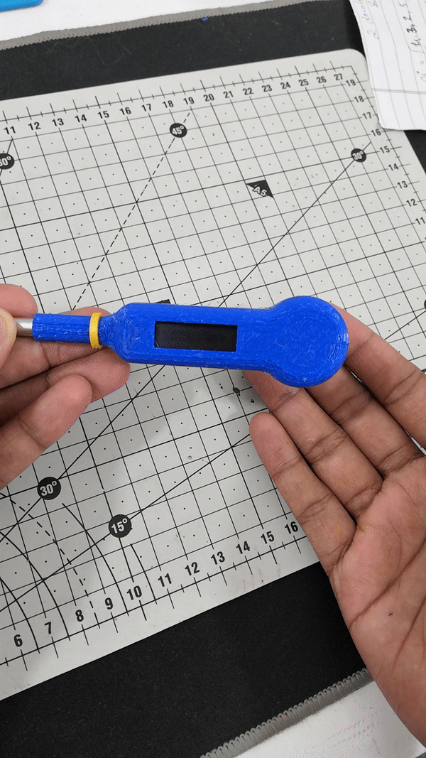

Step 20: 3D Model - 3D Printing
I have designed the model in fusion 360, it is not complicated as it looks.
if you like the design you can check out Github repo or download the STL files at the end of this step. I have the STL files along with the circuit diagram and the code. Okay, so the model is ready, Let’s print it! I’m using PETG with 0.2mm layer height, 245C nozzle temperature, 70C heat bed temperature and 40mm/s speed. Even with slower speed it was harder for me to work with PETG and caused a lot of stringing in the model. If you guys have any tips/tricks drop them below!
Step 21: Assembly
Assembly can't be simpler than this. Just use a little bit of the glue or insulation on the solder joint so the piezo doesn’t short the circuit. Then place the circuit on the bottom case and close the top case. Now use the ring to close the other side.
That’s it we are done!
