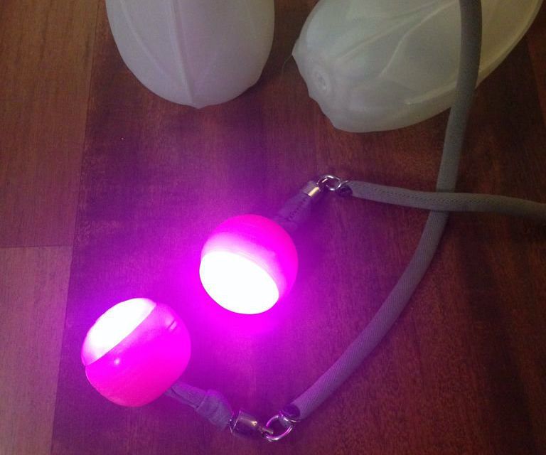

- (2) Handles — I recommend Ultraknobs if you want LED handles, Widmars or PomGrips if not (I prefer Widmar XLs myself)

- (Optional) Roll of Velcro tape (at least 3/4" or 2cm wide) — you can add this to Ultraknob handles if you're having problems with the lights flying out
