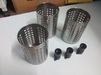

This Modern style is made from 3 metal spoon holders from IKEA. They are brushed steel with nicely distributed holes, inspired me to use them to build this shed.
Material list:
- 3 X metal spoon holders from dollar store or IKEA
- 3 X screw bulb holder (choose any size depends on what kind of bulbs you have)
- 3 X LED bulbs each 7 watts. I used screw type.
- Some surplus wires and aluminum angle, or any section long strip. surplus wood strips also will do length about 50 cm ( = approx 20 inch)
- some screws

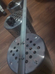

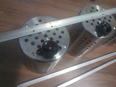

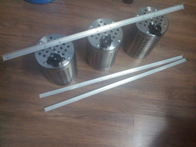

Step 2: Let S Do It

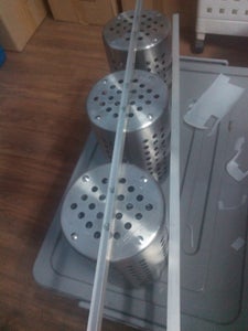

Cut the strips 1 or 2 or 3 up to your taste and cut to 50 cm length.

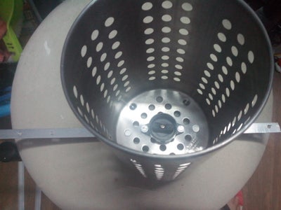

then fix the bulb holders on the stainless steel tin.

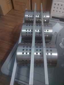

then connect the three tins together with the strips you cut.(if you do not have metal strips, you can use any wood strips, they sit well with the steel tins)
use any available screws but ensure they look presentable to make a professional job.

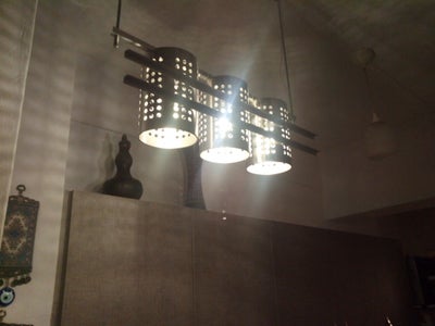

After that connect the wiring together and test it before handing.
easy breezy, Good luck.
Step 3: Last Words
- Please use LED instead of usual bulbs. This will save you money & energy, and help environment.
- Use warm white LEDS. because pure white will look like a neon and not really good looking.

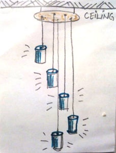

- this can work also as wall hung light, you may also make 5 pcs like chandelier and hang them spirally (see sketch)
