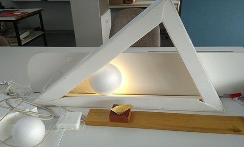

Step 3: Cut Wood - Long Mitres on Table Saw
Cut the planks longways, so that you are able to get 2 lights out the wood (2 lots of 3 pieces - 6 pieces total).
Note: please get assistance with this step if required. I had not trained in this type of cutting at the time, and as this project was done while I was a student, for safety reasons the Technician did the cutting. There are plenty of videos on You Tube about how long miters are cut on a Table Saw.
  • The angle of the cut is 68.7 degrees, 15mm from the longest edge.
  • Final sizes needed:
  • 2 x 800mm L x 90mm W x 50mm T
  • 2 x 700mm L x 90mm W x 50mm T
  • 2 x 522mm L x 90mm W x 50mm T
Step 4: Cut Mitre Joints
Cut the wood pieces at the ends to create the mitre joints that make up the triangles.
  • The triangle joints are made up of 3 angles: 40°, 60° and 80°.
  • From what I have read online, the best tool for precision mitre joints, where the angles are not 90 degrees, is a quality mitre saw with a sharp, fine-toothed blade.
  • Note: please get assistance with this step if required.
  • As this project was done while I was studying, the technician was required to do the cutting. We first created a test piece using some spare MDF. One of the angles ended up being 59° instead of 60°. The technician used a jig to assist with cutting on the Table Saw at the desired angle.
