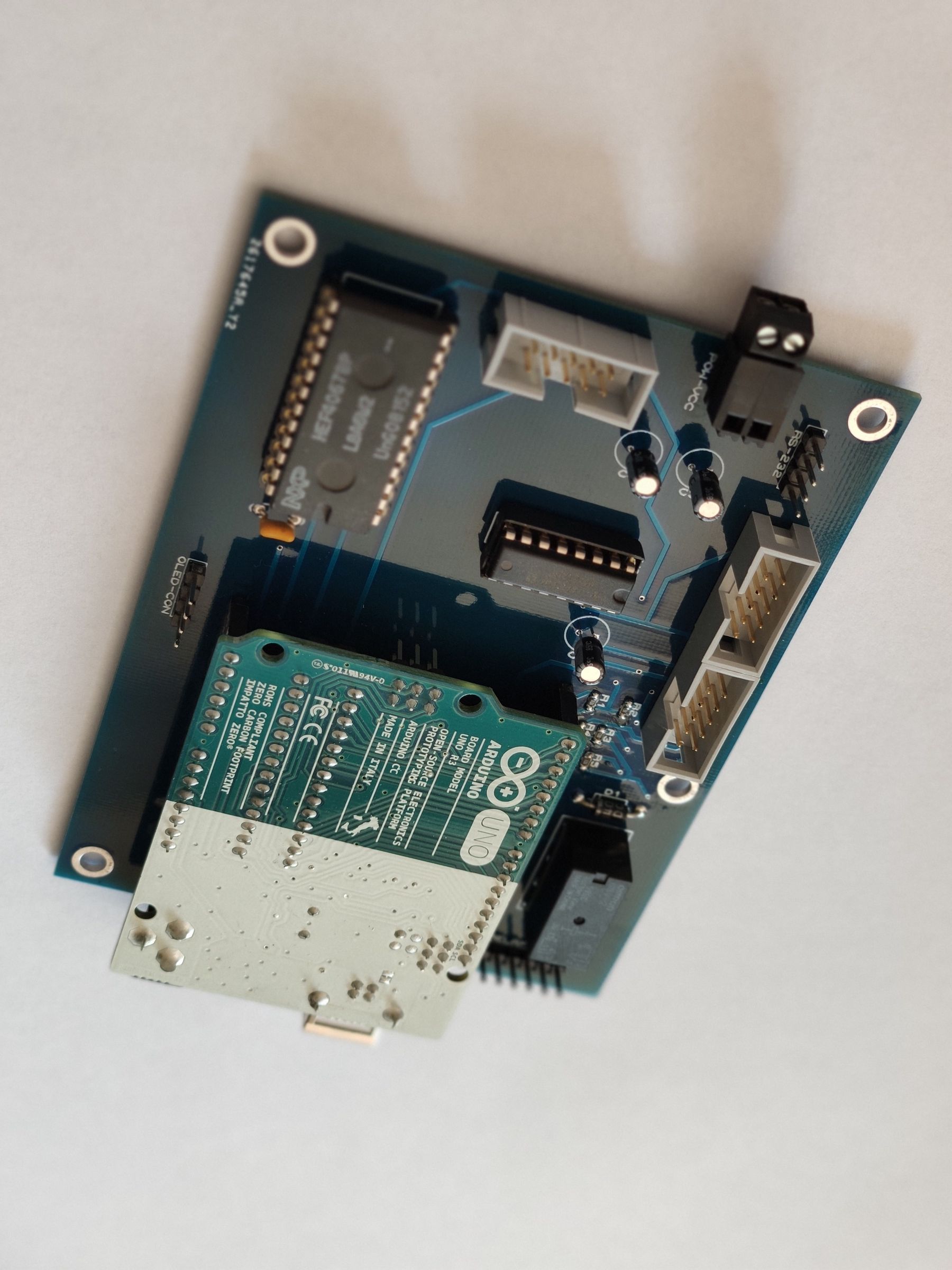

here is the Gerber file to make it.
The arduino is direclty inserted up-side-down on the PCB (like a shied).
known issues :
- the CD4067 used for the switch section of composite video is not properly power supplied. The schematic gives a 12V power, but it's driver with 5V logic signals by the Arduino... so the inputs stays on the first anyway (00000).
- It's the same issue with the MPC506 chips, but the logic levels are properly considered by those components, so nothing to change about that.
So you'll have to slightly modify the PCB, but it's manageable if you use IC supports, and add some wires.
