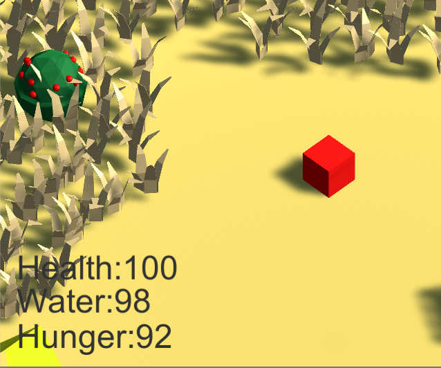

The game is fun, but now the issue is that the player doesn't have any information. The player can't see their health, the amount of ammo, etc. When we create our UI, we need to make sure to create...
  • Gameplay UI showing Health, ammo, and other stat
  • A main menu
Explanation of the UI
The UI system in Unity has its own separate "package" in the script, which means we'll have to use the "using" command to bring it in. The way it works in the editor is through a canvas system.
  1. The highest "layer" is the canvas object, which has the other individual UI elements inside it. By controlling the canvas, you can control things like the scale, visibility, etc of the UI elements inside it.
  2. The layer below the canvas object is where the individual UI elements reside. Elements like text, image, etc are here and can be controlled individually.
UI elements themselves can be treated like game objects, so the previous procedure to get game objects into scripts can be used for UI (Dragging them in using the editor, GetComponent<>)
In (Picture 1), MasterCanvas is the Canvas, which holds the EventSystem and another Canvas which itself holds the gameplay UI.
(Gif 1) is a demonstration of what the UI will look and act like.
(Picture 2) is what we'll be making in the next slide, making the gameplay UI.
Step 9: User Interface: Gameplay UI
Gameplay UI
The gameplay UI needs to include text that displays current health, water, hunger, and ammo. Because UI elements can be treated as game objects, we can create UI elements by right clicking on the hierarchy and going down to UI (Gif 1).
  • We create four text elements under a single canvas, making sure to name them so we can easily use them later. We adjust their positions, sizes and scaling so that they're the appropriate size.
  • We create the script above and attach it to our GameManager object. We drag in the text we just made and drag in the Player object into the script so the script has information.
Once the information and text has been dragged into the script, the text should start updating with the current numbers of Weapon_Parent and Player_Manager.
Now, we need to create our main menu.
