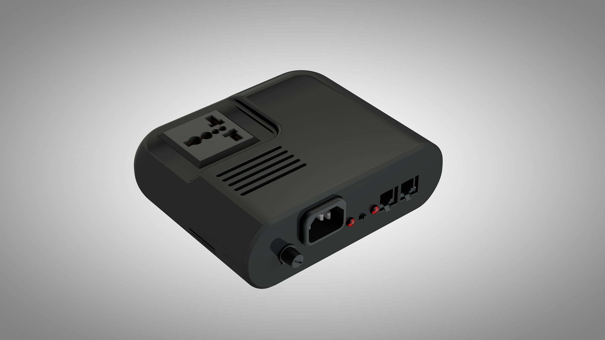

Step 2: What Is Sugar ?
Sugar is revolutionary device designed to control AC Loads working on 110V/220V ,Designed especially For Students , teachers , Engineers and Makers How are looking for a tool to Control AC Voltage and to be easy to connect and easy to program.
With Protect cover case sugar offers a high level of safety,No electrical shock could happen and allow to anyone want to learn , design and innovate any AC power project.
Sugar can be controlled through RJ12 Connector , and control The AC Output voltage using PWM , so just send PWM signal to sugar , and you will be able to control the device connected to Sugar in this way.
Sugar can control AC voltage in 2 different Way:
- Control AC voltage as a Switch ON - OFF
- Control Output voltage which is suitable or many Application like AC Lamp dimmer , AC Motor speed control , AC heater temperature control.
Sugar with this features and be controlled from any Electronics platforms , Like MCU (AVR , PIC, STM ,Ti ) or Development Board (Arduino , Raspberry Pi , Beagle bone , teensy , ARM ) all you need is PWM Signal to control Sugar device.
You can Read more About the features of sugar inour official website
