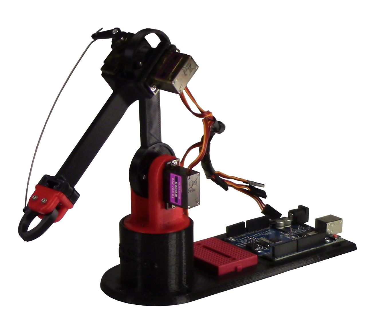

This tutorial uses the LittleArm 3D printed Arduino Robot Arm as a base.

- LittleArm Brainless Kit
- Meped Control Board
- Arduino Nano
- HC-SR04 ultrasonic sensor
This tutorial is for basically plug-and-play components. In the future I will provide a more scratch-built tutorial. If you have a 3D printer and some extra MG90S servos you can build the LittleArm from scratch instead of getting the kit. The 3D files are here.
