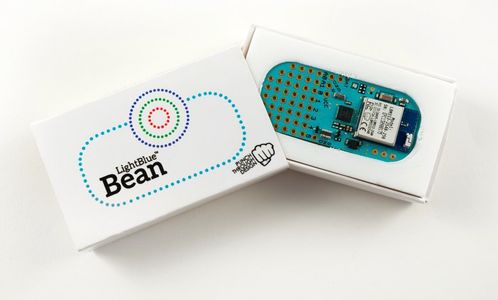

We will be using an Arduino compatible microcontroller called the LightBlue Bean. It connects to your phone over BLE and comes with an iPhone app that you can use to control it. You can order a LightBlue Bean here.

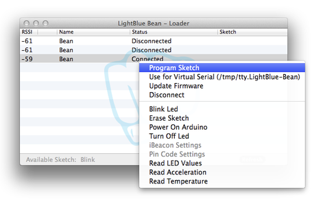

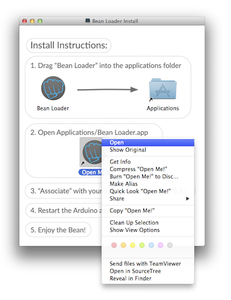

The LightBlue Bean is programmed wirelessly using an OSX application called Bean Loader. Download it here and follow the installation instructions.
The first time you open the Bean Loader it will ask you to associate it with the Arduino app. When the notifier pops up click "Associate".

Open the Bean Loader application and connect you your Bean. Make sure to update the firmware if it tells you to.
Program the sketch and disconnect from the Bean when it's done!
