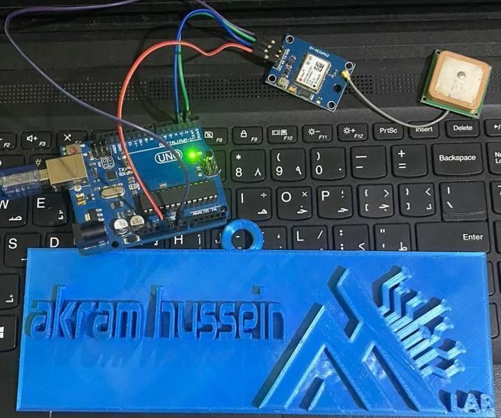

Step 2: Reading Voltage
after determining the resistor values, I used a voltmeter to validate the calculations, and then I wrote the following code to measure and read the voltage. "picture 1"
To read the Battery voltage and print it on the serial monitor the code will be:
float readingbattery= analogRead(A2) * (5.0/1023.0);
Serial.println("Battery: " + String(readingbattery));
"picture2"
