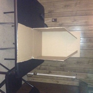

Step One: Choose a side to tape together, this will be the bottom end of the box. Now choose a side of the box you want to cut open. Be careful not to cut it all the way off! You'll be using this portion of the box as a flap to place the controls on (See first image).
