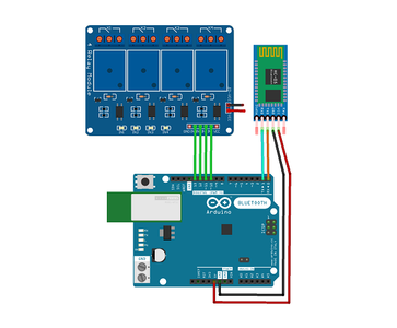

Step 1: Wiring
You need to connect the Bluetooth module and the relay module with Arduino. The wiring between Arduino, bluetooth and relay is given above. Here's the Connection between Relay Module, Led strip, and input power:
  1. Connect common-point (com) of Relay Module with Christmas lights.
  2. Connect normally-close (nc) of Relay Module with power.
  3. Connect remaining one home light wire with the power source.
NOTE: Number of outputs depends on you relay module.

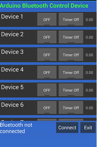

Step 3: Android App
Download and install the Android application of Arduino Bluetooth Controller.
