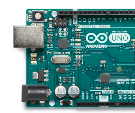

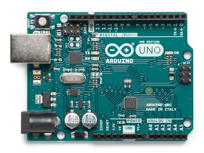

1)Arduino Uno R3 micro-controller board (Quantity: 1)

1) Arduino Uno R3 micro-controller board: Most probably you might be familiar with Arduino micro-controllers. For those who are not, you can assume it as of a core component in most of your IoT(Internet of Things) projects. In this project I have used " Arduino Uno". ATmega328 based MCU. It has 14 digital I/O pins (of which 6 pins can be used for PWM output), 6 analog input pins, operates on 5V and input voltage ranges from 7V-20V, 20 MHz clock speed with 32 kb flash memory.
We can connect various sensors to it and put our logic in a code to get the required functionality from sensors and upload the final sketch to Arduino through 'Arduino IDE'.
