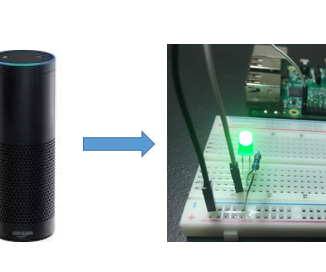

Connect the circuit:
- Use a jumper wire to connect the ground ( Pin 3) of GPIO to rail marked in blue on the breadboard.
- Connect the resistor from the same row on the breadboard to a column on the breadboard.
- Connect the LED with the cathode in the same row as the resistor. Insert the anode in the adjacent row.
- Use another jumper cable to connect the GPIO Pin 21 ( 3.3 V) in the same row as the anode of LED.
This completes the circuit. Refer to the picture and the schematic above.
