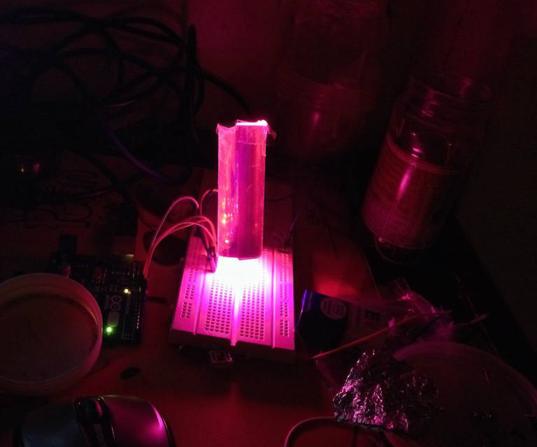

We will make a Remote Control LED brightness controller, it is very simple. Comment below your question if you have any, I will love to answer them all. My blog for Latest Tech News and Some Projects Electronics Time.

Step 2: Circuit Daigram
Simply Hooking up IR receive pin to pin 11 and other two pins of IR Sensor to 5V Supply and Ground of arduino. Connect LED to pin 9 and Ground.
Step 3: Code
Simply run the code in your Arduino IDE and see the beautiful project i action. But, first check your remote control signal by using the IR library on Github. FYI the IR library runs on Arduino IDE 1.0.5 so, if you have arduino IDE version 1.0.6 then downgrade it to 1.0.5 after saving your projects to other place in your PC. Link For Previous versions of IDE.
