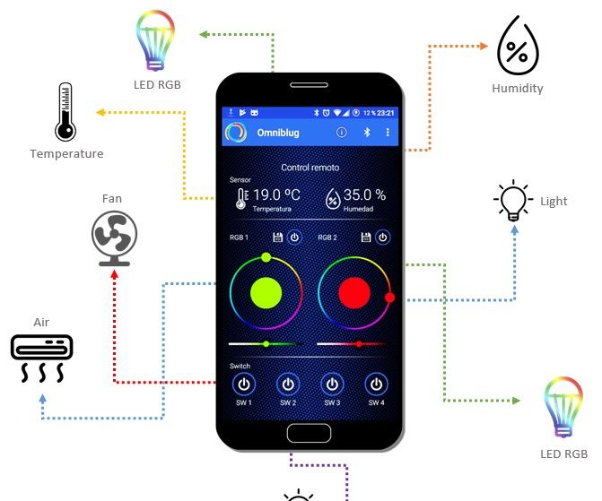

Build your own home automation arduino project where you can control the temperature and humidity thanks to the DHT-11 temperature sensor, you can also control the lighting thanks to the RGB LED strips and manage several devices wirelessly using the JY-MCU bluetooth module from your own mobile phone.
Choose the hue of light that makes you feel more comfortable.
- Control temperaturye and humidity
- Simple bluetooth remote control from which you can modify lighting from your mobile device or tablet.
- You have two separate RGB channels where you can get different colors per channel.
- Control adjustable intensity.
- Control switch 4 chanel.
- Do it yourself .
- Thanks to the arduino platform in minutes you 'll Omniblug armed and ready for use.
Discover all the features provided. Is very easy install this small device.

Finally, we will installed the application Omniblug on your Android device.
We access Google Play and installed .
https://play.google.com/store/apps/details?id=com...
Once you open the application you will be asked to connect with our bluetooth device, perform a scan and select device Omniblug to connect .
Insert the pin default "1234".
Since implementation options we can modify the pin of device to prevent other applications from connecting . However we only ask for the pin the first time to proceed with our Omniblug matched .
If pairing was successful , our application will change to the control screen .
That's it .
We have our unit control RGB LED running.
