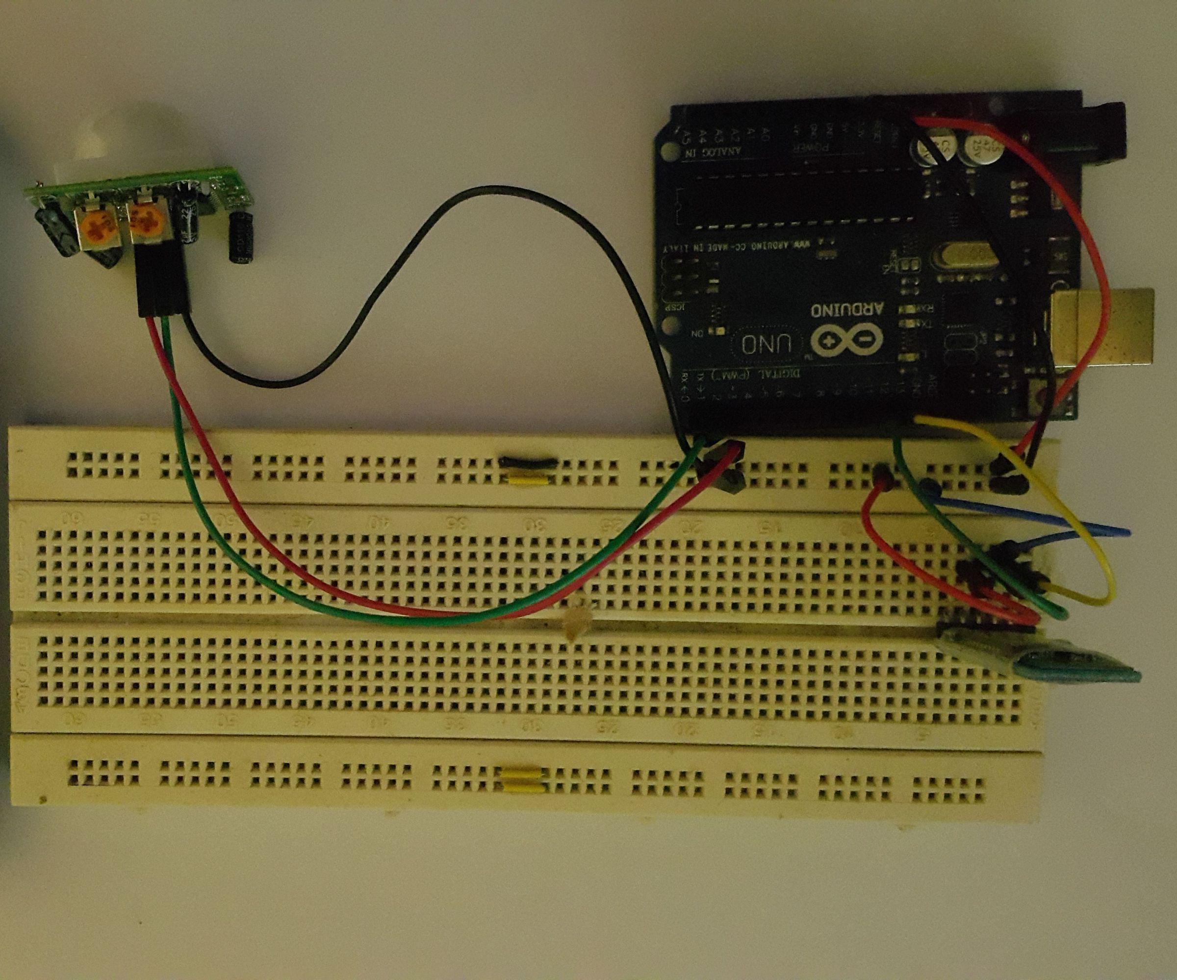

Step 2: Circuit
Bluetooth module connection
- connect the BT module's Rx pin to pin 11 on the Arduino
- connect the BT module's Tx pin to pin 10 on the Arduino
- connect up the Gnd and Vcc (5v) to the Arduino
Led's connection
- connect all the cathodes(short pin) of the led to Gnd
- connect each anode to a 220Ω resistor
- connect a resistor to Arduino pin 2,3 and 4
If the led on the Bluetooth Module is blinking quickly then it is ready to pair to your phone,if not then check your connections
Circuit Complete! now lets move on to the code
