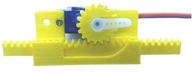

  1. Arduino UNO (Or any other Arduino)
  2. Linear Servo Actuator

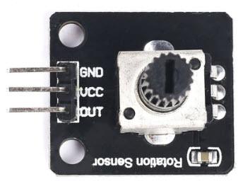

  3. Potentiometer module

  4. Connect potentiometer module pin [Out] to arduino analog pin [A0]
  5. Connect potentiometer module pin [VCC] to arduino pin [5V]
  6. Connect potentiometer module pin [GND] to arduino pin [GND]

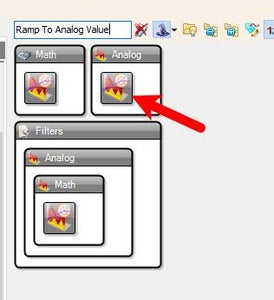

  1. Add "Ramp To Analog Value" component (This component is not necessary, but it ads a smooth start of the servo, so it is recommended, you can adjust the values in the properties window)

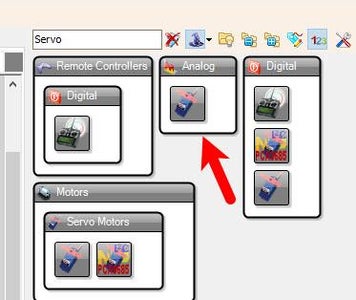

  2. Add "Servo" component

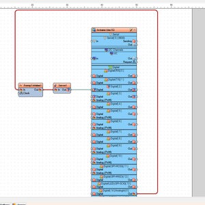

  1. Connect Arduino analog pin [0] to "RampToValue1" pin [In]
  2. Connect "RampToValue1" pin [Out] to "Servo1" pin [In]
  3. Connect "Servo1" pin [Out] to Arduino digital pin [2]

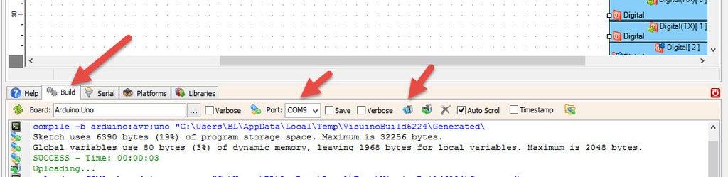

Step 5: Generate, Compile, and Upload the Arduino Code
In Visuino, at the bottom click on the "Build" Tab, make sure the correct port is selected, then click on the "Compile/Build and Upload" button.
