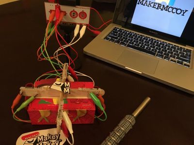

After deciding what type of project you are going to create you can add a reed switch to the area where you are going to connect your alligator clips.
Here is a link where you can order a reed switch for .18 cents per.
https://www.arrow.com/en/products/flex-14-10-15/li...
- Clip one lead of the reed switch to a key input on the Makey Makey.
- Clip one lead of the reed switch to earth on the Makey Makey.

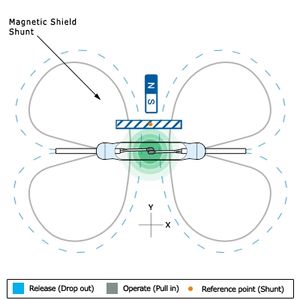

To learn more about reed switches click on the link below.

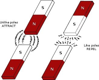

Step 2: Choose What Type of Magnets to Use.
Magnets used in this demonstration:
- Neodymium magnets
- Ceramic Magnets
Tip: You can find rare earth magnets in old hard drives.
