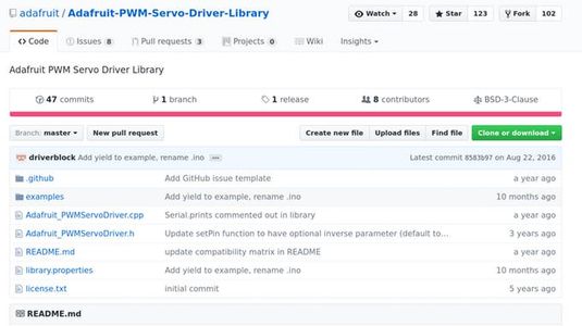

This project uses an Adafruit PCA9685 16-channel servo controller, it can control max for 16 servos through I2C interface. Although you can control servo directly from your Arduino’s PWM pins, we suggest to use additional board to control for protection and better performance.
Please download Adafruit-PWM-Servo-Driver-Library from Adafruit’s github page. Click Clone or download / Download ZIP at the top-right corner of this webpage.
Here need no extraction, please import this library from Arduino IDE / Sketch / Include Library / Add .ZIP Library. It will be added into Arduino IDE/libraries folder.

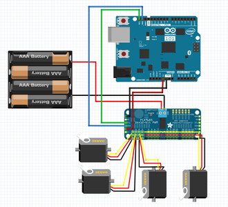

Step 2: Hardware and Circuits
  • Servo to PCA9685: Please connect four servos to PCA9685 board’s 3-pin port #0~#3, beware not to connect in wrong direction!
  • Battery to PCA9685: Connect your battery holder's red/black wire to PCA9685’s +/- power terminal. When you try to control multiple actuator like servo, DC motor, it is very important to support them by separate power supply in case of insufficient current. This may cause Arduino 101 to be malfunctioned or damaged.
  • PCA9685 to Arduino 101: As for I2C interface, please connect its SCL/SDA pins to Arduino 101’ SCL/SDA pins separately.
  • Arduino 101’s power supply: Please connect PCA9685’s V+/GND to Arduino 101’s 5V/GND pin. Your Arduino 101 will use power from PCA9685 to start working. Finish.

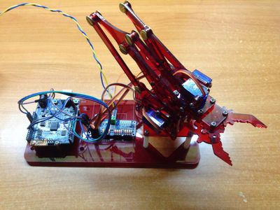

Your project will look like figure below, another advantage of using PCA9685 is that we can get rid of breadboard and disorderly wires. Enjoy!

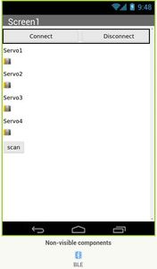

Step 4: App Inventor’ Designer Page:
Please add components as figure below:
Listpicker x 1: Store BLE device list and click to connect.
Button x 2: one for start scanning BLE devices around, another is to disconnect from BLE device (Arduino 101).
slider x 4: drag to control corresponding servo. Please set all sliders’ MinValue field to 150 and MaxValue field to 600, this means the pulse value range we are sending to control those servos.
label x 4: show servo port number and servo pulse value.
BLE x 1: send/receive data by BLE.
Your Designer should be very similar like figure below, but doesn’t have to br exactly the same. The Scan button
