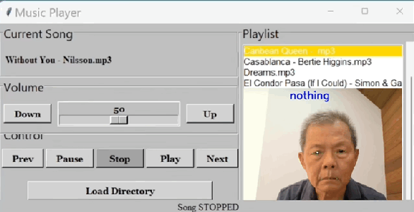

Step 1: Music Player
The music player is a GUI-based app with various buttons to perform functions such as loading, selecting, playing, pausing, and resuming songs. It uses the Tkinter, Pygame, and OS modules to simplify development. If these modules are not already installed on your system, you will need to install them.
  1. Tkinter is used for setting up GUI components like buttons and labels, as well as for dialogs and displaying messages.

Each button is linked to its corresponding function. For example, the play button is linked to play_song() like this:Image description
After many iterations, the player works very well. The source code is available on my GitHub repository. You can also download the standalone executable version and use your mouse to test it.

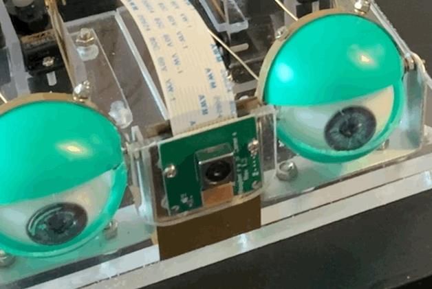

I have written two articles previously: Control Robotic Eyes With My Eyes Using AI and Deep Learning. and How to Train Custom Hand Gestures Using MediaPipe. In these articles, I describe how to collect data, train models, and deploy the trained models for inference. You can follow these guides if you wish to create your own hand gesture or eye movement models.

Step 3: Connecting Gesture Detection With Music Player
Using thread:
I repackaged earlier scripts (eye_detect.py, iris_detect.py, and hand_detect.py) into a function called process_frame(). The root.mainloop() call, responsible for starting the Tkinter GUI, is placed at the end of the script after the process_frame() function. Since process_frame() runs continuously in an infinite loop to process camera frames and detect gestures, it blocks the execution of root.mainloop(), preventing the GUI from appearing.
To resolve this, I run the MediaPipe and OpenCV processing (the detection part) in a separate thread so that the Tkinter GUI can run concurrently without interference. Here is the code that achieves this:Image description
