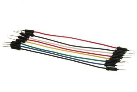

  • Jumper wires

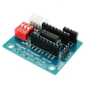

If using a Stepper Motor Driver Shield:
  • Connect Motor Shield GND pin to Arduino negative pin [GND]
  • Connect Motor Shield [5V] pin to Arduino positive pin [5V]
  • Connect Motor Shield GND pin to Power Supply negative pin [GND]
  • Connect Motor Shield [9V] pin to Power Supply positive pin [+]
  • Connect Motor Shield pin[S] to Arduino digital pin [2]
  • Connect Motor Shield pin[D] to Arduino digital pin [3]
  • Connect stepper motor as shown on the picture.

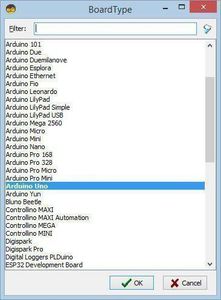

Step 4: Start Visuino, and Select the Arduino UNO Board Type
Start Visuino as shown in the first picture Click on the "Tools" button on the Arduino component (Picture 1) in Visuino When the dialog appears, select "Arduino UNO" as shown on Picture 2

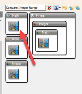

Add "Counter" component
Add "Compare Integer Range" component

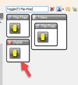

Add "Toggle(T) Flip-Flop" component

  • Select "CompareRange1" component and in the properties set "Include Limits" to True and "Range" > "Max" to 20000
This means that as long as the number is within the range of 20000 the Motor should run

Connect "DigitalMultiSource1" Pin[0] to "TFlipFlop1" Pin [Clock]

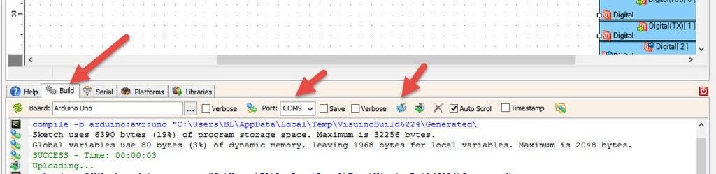

Step 8: Generate, Compile, and Upload the Arduino Code
In Visuino, at the bottom click on the "Build" Tab, make sure the correct port is selected, then click on the "Compile/Build and Upload" button.
