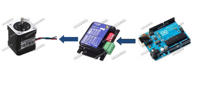

Step 1: Control 4.2 Kgcm,4.4 Kgcm,10 Kgcm Motor With Arduino and Micro Stepping Drive
Part to be Required
1.Rhino Motion Control Microstepping drive (Rmcs 1106).
http://robokits.co.in/motor-drives/stepper/micro-stepping-stepper-motor-drive-12-40v-2amp
2.Arduino board
http://robokits.co.in/development-boards/arduino-uno-r3-original-made-in-italy-with-box
3.24 v industrial Smps Power supply .
http://robokits.co.in/power-supply/industrial-power-supply/12v-10a-industrial-power-supply
4. Stepper motor
http://robokits.co.in/motors/stepper-motors/nema17...
Step 2: Connection Diagram
