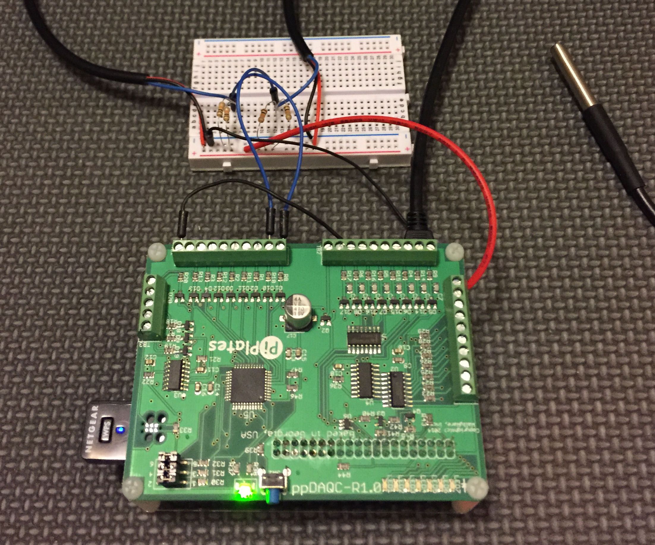

The ppDAQC board from Pi-Plates.com is an inexpensive yet powerful solution for expanding the input/output capabilities of the Spark Core. And since Pi-Plates are stackable, it is a simple task to scale up the I/O capabilities of a single Core. All that is required for connectivity are the four SPI signals (signals A2-A5) as well as a single digital output (D6). Power can come from the Core or from the ppDAQC board.
Step 1: Required Components
To build this assembly the following components are required:
1. A ppDAQC board from Pi-Plates.com
2. A Spark Core
3. A 5VDC power supply or the USB power supply included with the Core.
4. A small protoboard (currently included with the Core Evaluation kit)
5. Jumper wires

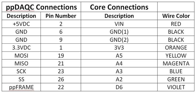

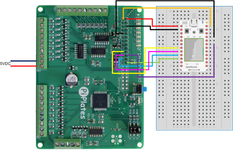

Step 2: Connections - 1
The diagram and table explain how the ppDAQC and the Spark Core board are connected. This implementation uses an external 5VDC supply that provides power for the Spark Core through the ppDAQC board. This approach allows you to drive peripherals with the open collector pins that would pull more than 1 amp. If you’re just playing around, use the USB power supply that came with your Spark Core.
