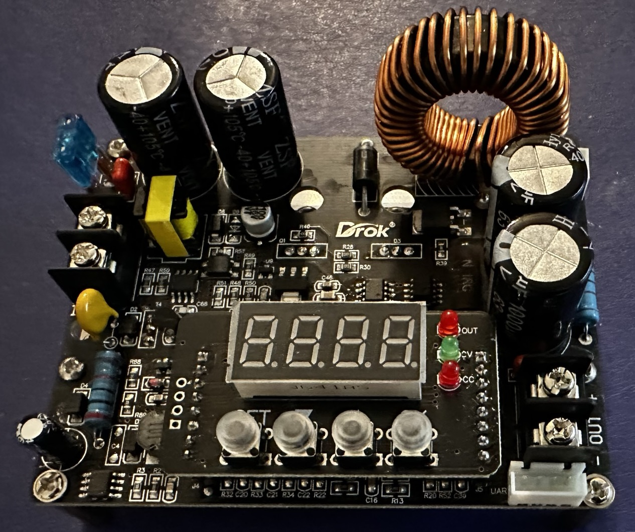

This instrucable is intended only as a way to test a new PSU; Validate that the PSU is functional and document the commands.
- PSU: manufacturer (Amazon); support
- ESP32: manufacturer (Amazon)

Step 4: Set the PSU Address
This version of the PSU can have one of 26 addresses - represented by the alphabet.
As shipped most PSUs seem to have a false setting "-51-" and need to be set to the first address "-00-" (aka 'a').
Press and hold (for < 1/2 second) to launch the menu.
Use the up triangle to reach "-F3-", click OK.
Scroll down, using the down triangle, until "-00-", press OK.
Disconnect power, wait 10 seconds, reconnect power.
Verify the -F3- setting is still -00- (One PSU needed to be set 3 times before it saved correctly)

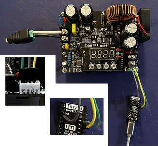

Step 5: Connect Serial
The UART in the ESP32 can be assigned to any pins.
For this instructable:
- ESP32 Pin 4: RX (receive) => PSU pin "R"
- ESP32 Pin 5: TX (transmit) => PSU pin "T"
(note: typically transmit, on the controller, goes to receive on the device, but that is not how this PSU is labeled)

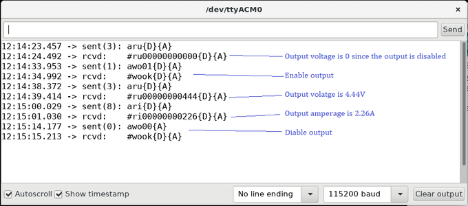

Step 7: Usage
In a serial terminal (e.g., the Serial Monitor in the Arduino IDE) enter/send a number corresponding to a command.
Observe the result received from the PSU.
(in the code, see the comments in the array declaration for what each number does.)
Step 8: Conclusion
Notice the commands are inconsistent; some binary commands use 0/1 others use 00/01.
Some terminate with carriage-return (\r) new-line (\n), others use only \n.
Determining what worked was a significant trial & error process. Thus, while this works in this scenario, with this version of the Drok PSU, your results may vary.
