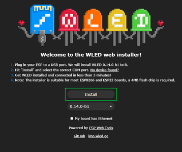

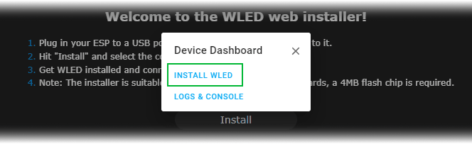

  1. First go to official website of Wled. Here you can see the option for installation. Also you can select the version of Wled, my recommendation is to use the latest version. Click on Install.
  2. Now Connect Your ESP32 Microcontroller with your laptop. At the right side you'll see the option for com port selection. Select your connected Port and click on connect. Also Make sure that CP2102 Driver is pre-installed in your laptop. If it's not, then download it from here.
  3. Now you'll see two options Install WLED/ Logs & Console. Simply Click on install Wled to upload the firmware into ESP32.
  4. If you're getting errors then press the BOOT Bouton for 2 Seconds, it will erase all your data from ESP32.

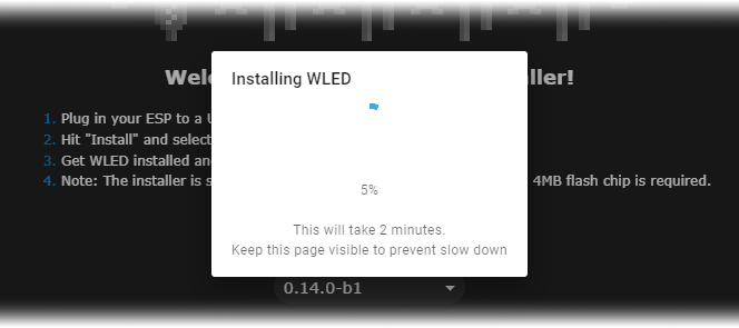

  5. Now re-click on install to upload the firmware once again.
  6. Now it'll just take only 2 minutes to upload the firmware.

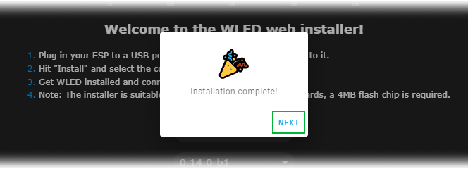

  7. After 2 minutes you'll see congratulations Installation Complete message, simply Click on Next

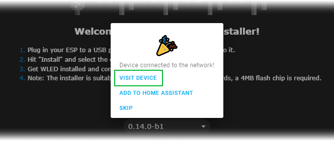

  8. Now enter your SSID and Password of your wifi network, make sure your smartphone and Wled application is connected with same wifi network. After entering the details, click on Next.
  9. Now You have successfully completed the installation process, simply Click on Visit Device for LED Configuration.

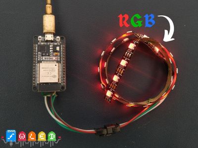

Step 4: Conection
Now Connect your Ws2812b RGB led strip with your ESP32 Microcontroller. You may follow the above image for reference.
