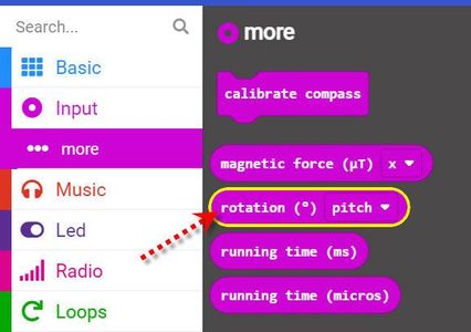

The program on the remote control side is straightforward. It reads both the roll and pitch angles from the accelerometer sensor. If the orientation changes to more than 30 degrees or less than -30 degrees, it will trigger the program to send a command to the robot arm to move according to its design.
In the initialization state of the robot arm program, we need to set the initial angles (save in variables) and instruct all four servo motors to move to the starting angles. When it receives a command from the remote control, it interprets which servo motor the command is for.
To improve program readability, I created four functions to calculate a new angle for the servo and move the servo to that angle. In each function, I used a "constrain" block to limit the angle between two values.

As you may know, the micro:bit is equipped with a magnetometer sensor that can detect magnetic field strength. This sensor is located on the back of the micro:bit board (as shown in the picture). I attached a neodymium magnet to my little finger, so when I closed my hand, the sensor detected a strong magnetic force.
After some experimentation, I found that the sensor reported a value of more than 300uT (micro Tesla) when it approached the neodymium magnet. Instead of checking whether button B was pressed, I modified the program to detect high magnetic force. This way, when I closed my hand, I was able to control the grip to move up or down. And when I opened my hand, I could control the robot arm to move forward or backward.
