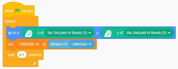

  3. Measure the distance from the base of the thumb to the base of the little finger as a reference. This is a palm size

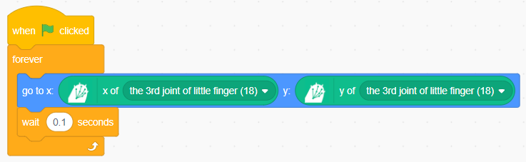

Step 7: Code for Wrist, Thumb Base, Little Finger Base
These codes just move sprites to track position.

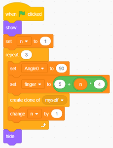

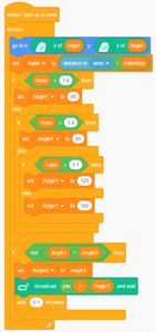

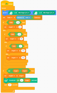

Step 8: Code for Tips of 5 Fingers
I separate code for the thumb and little finger. For the index, middle, and ring fingers, I just write one code and clone it to 3 fingers.
In the last part of each code, I use micro:bit broadcast and wait to send the servo number and angle to micro:bit. and let micro:bit control servo.
