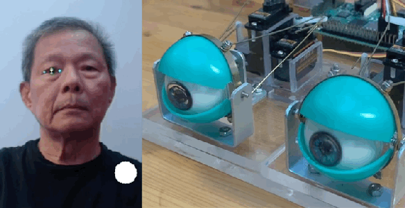

The objective of this project is to control the rolling and closing of a pair of robotic eyes using the movement of my own eyes. A computer vision-based Python program, utilizing the MediaPipe framework, is employed for real-time detection and tracking of my eyes in video frames, triggering the robotic eyes to respond and follow. After my initial attempts, I found it challenging to differentiate between the upward and downward rolling of the eyes. Therefore, I implemented a deep learning algorithm in artificial intelligence into my program. This article describes how the approach was executed and what the outcomes were. All codes are available on my GitHub repository.

In the past, I created a pair of robotic eyes that can be controlled using an Android app. The eyeballs are connected to a universal joint, allowing them to move in the x and y directions. The upper and lower eyelids are made from halves of a 40mm lottery ball, hinged together using brass strips for opening and closing. The pushrods connecting the servo horn to the eye are made of 1mm brass wire. Two servos per eye are used to control the eyeball movements in the x and y directions, while one servo handles the closing of the eyelid. Before connecting them, the servo angles are adjusted to 90 degrees. The overall construction is shown above.

The animated gif file at the beginning of this article shows how I used my eyes to control the robotic eyes. The script works well when tracking the opening and closing of the eyes, as well as when the eyes are rolling horizontally. However, it doesn't accurately calculate the up and down rolling. I have adjusted the up-down threshold ratio many times to determine the rolling status. I found that determining whether the eyes are rolling up or down is nearly impossible. I plotted the ratios for left-right movement and up-down movement. The plot shows that left-right movement has three clearly distinct regions: right, center, and left. However, the ratios for up-down movement are all clustered together. Even a slight forward or tilting movement of the head in front of the camera can result in different ratios.

The results are demonstrated in the video above. The first part is the computer simulation on my laptop and the second part is running on Pi to control the robotic eyes. In summary, the scripts successfully detect and control both the graphical eyes and the robotic eyes. Unlike my initial approach, this method can differentiate between up and down rolling. However, since I only collected a limited amount of data for each eye gesture (between 50 to 75 samples), I sometimes need to move my face and adjust its angle in front of the camera to achieve the desired results. To improve accuracy, you may want to collect more data or include datasets from other individuals for each eye movement.
