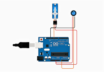

Step 2: CIRCUIT DIAGRAM
Follow the circuit diagram for making connection.

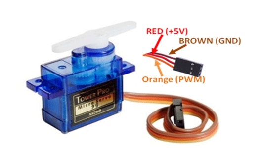

Arduino To Servomotor Connection :-
5V - VCC
GND - GND
D11 - PWM
Arduino TO Potentiometer :-
5V - 1st Pin
A0 - 2nd Pin
GND - GND
