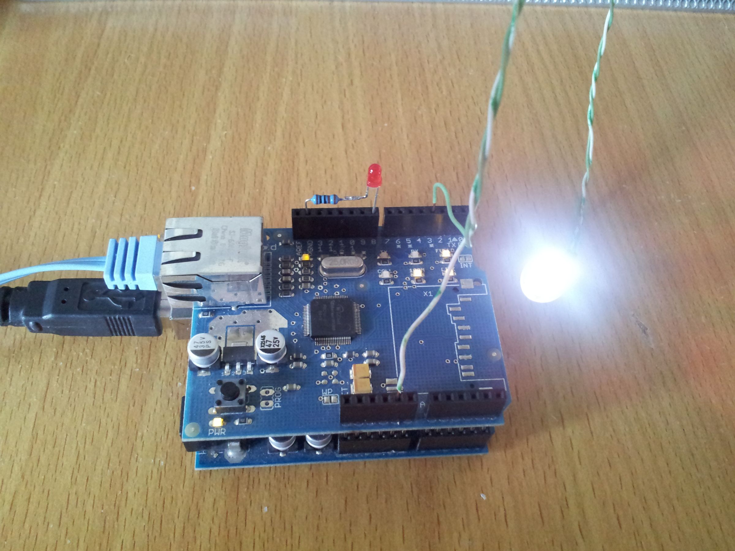

Step 2: Put Circuit Together
The image shows the circuit put together using hookup wire and a breadboard. Compare this against the circuit diagram in the previous step to help put your own circuit together.
Do a quick Google search to work out the pin-out for your particular servo.
For the servo used in the tutorial: yellow = signal, red = 5V, black = GND.
Any available digital pin on the Arduino can be used, just make sure you take note of which pin you connect it to so that you can reference it in the API calls later in the tutorial.
