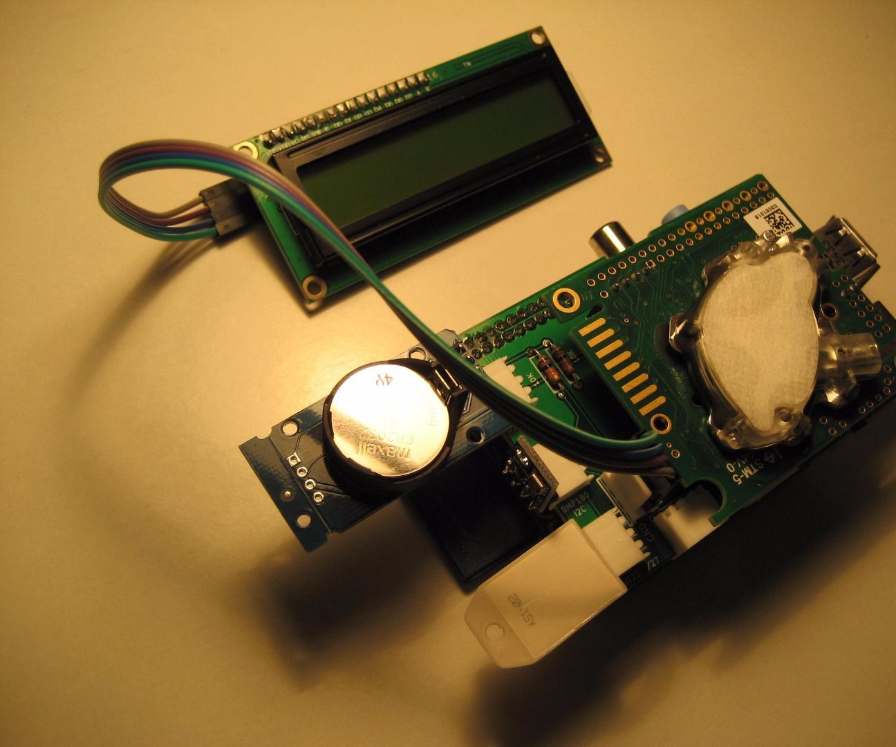

This tutorial describes how to control a Sonoff switch from a Raspberry Pi. I plan to use Sonoff with my LiV Pi device to turn on an AC unit when CO2 levels exceed a defined threshold. The code should work on any Python-enabled platform able to send HTTP requests. I hope this tutorial will save time to someone setting up his Sonoff switch.
