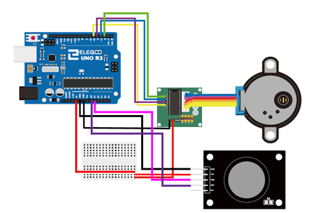

In this project we want to control stepper motor using joystick and arduino uno
Step 2: Components Needed
1- arduino uno
2-stepper motor
3-ULN2003 stepper motor driver board
4- wires
5- breadboard
Step 3: Programming Code
#include stepper.h
const int stepsPerRevolution = 2048; // change this to fit the number of steps per revolution
const int rolePerMinute = 15;
const int X_pin = 1; // analog pin connected to X output
Stepper myStepper(stepsPerRevolution, 2, 4, 3, 5);
void setup() { myStepper.setSpeed(rolePerMinute); //Serial.begin(9600);
void loop() {
// Serial.print("X-axis: ");
// Serial.println(analogRead(X_pin));
int a = analogRead(X_pin);
if (a > 400 && a < 520) {
for (int i = 2; i < 6; i++) { digitalWrite(i, LOW); } }
else if (a < 400)
myStepper.step(-30); }
else if (a > 530) { myStepper.setSpeed(rolePerMinute);
myStepper.step(30); }
Step 4: Output Results
after uploading the code , and changing joystick position output results obtain
