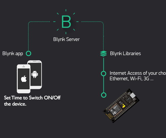

Yello... Yello...Yello...! Today, it's time for smart switch which we are going to control over internet using our very precious BLYNK app. Cool!
Overview:
The 5V relay connected to D5 pin of NodeMCU goes ON when D5 pin is set LOW and relay goes OFF when D5 pin is set HIGH.
We are simply going to set D5 pin HIGH to turn ON the appliance and D5 as LOW to turn OFF the appliance, considering the neutral wire is passing through the NC and COM of the relay.

Step 3: Blynk Setup
- Create a New Project in BLYNK app.
- Write Project Name and Select NodeMCU from dropdown.
- An AUTH token will be sent to your registered email, note this down.
- Tap on the screen and add a Button.Tap on the Widget and select D5 pin, then change MODE to SWITCH.
