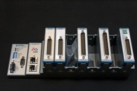

The cRIO is the central processing unit of a FRC robot. Using code generated in LabVIEW, C++, or Java, it takes inputs from the drivers and sensors and outputs instructions to motors, pneumatic solenoid valves, and other devices. While its operation can be as simple as mapping joystick values to motor speeds, it can also execute complex control loops and automated commands. The cRIO is modular, allowing teams to customize it to suit the needs of their robot.
There are two versions of the cRIO that teams may encounter. The cRIO-FRC is shown in the first picture and the cRIO-FRC II is shown in the second. The only practical difference between these two versions is the number of modules they support. The cRIO-FRC supports eight modules, while the cRIO-FRC II supports four. This smaller number of supported modules also translates to a lighter cRIO with a smaller footprint. The cRIO-FRC II was given to rookie teams starting in 2012, with veteran teams having the option to purchase one.
As the metaphorical brain of the robot, the cRIO connects with many different parts of the control system. Its swappable modules can be used to connect it to the Digital Sidecar, the Analog Breakout, and the Solenoid Breakout. The cRIO is powered by a 24V connection from the Power Distribution Board. It connects to the D-Link Router with an Ethernet cable allowing it to communicate with other components connected to the Router, as well as wirelessly with the Drive Station. Finally, the cRIO has a serial port which can be used to connect with the Jaguars through a CAN bus, which is one option for controlling the Jaguars.

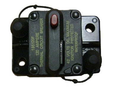

The positive terminal of the 12V battery connects to 120 Amp Circuit Breaker, while the negative terminal connects directly to the Power Distribution Board.
The 120 Amp Circuit Breaker is the robot’s on/off switch. It also limits the current draw of all electronics on the robot to 120A, though this limit can be broken for short periods.
The 120 Amp Circuit Breaker takes a direct connection from the positive side of the robot’s 12V battery at one terminal and connects it to the positive terminal of the Power Distribution Board.

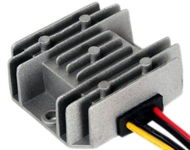

The final part of the robot’s power distribution system is the Router Power Converter. This component converts the 12V power dedicated to the router and converts it to the voltage necessary for the D-Link Router.
The Router Power Converter connects to the Power Distribution Board’s 12V router connection and to the D-Link Router itself.

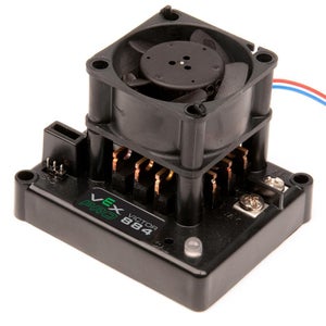

The Victor 884 motor controller is very similar to the Jaguar motor controller. Like the Jaguar, it controls the speed and direction of the motor connected to it. However, Victors can only be controlled with PWM cables and are therefore unable to take advantage of the benefits offered by the CAN bus. Still, many veteran teams continue to use Victors because they have a smaller footprint and are considered more reliable.
The Victor motor controller connects to the Power Distribution board through one of its 12V terminals and directly to a motor. It is controlled over PWM by the Digital Sidecar. Finally, a Victor’s cooling fan must be connected with the wires running to the Power Distribution Board.

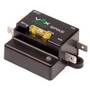

The Spike relay essentially functions as an on/off switch for components. When used with motors, it can be used to drive them in forward, reverse, or off. The Spike can also be used to turn on or off other electrical devices such as lights or a compressor. Finally, the Spike relay has a port for a 20 amp circuit breaker, in addition to the breaker on the Power Distribution Board.
The Spike connects to one of the Power Distribution Board’s 12V 30 amp terminals. Its outputs can be connected to motors, a compressor, lights, or solenoid valves. It is controlled via a PWM connection to the Digital Sidecar.

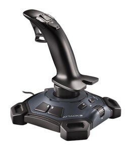

The final component of the Driver Control Station is the controllers themselves. Teams have the option of using virtually any USB powered controller, whether it is one of the included joysticks, an Xbox 360 gamepad, or some other controller of their choosing. Many teams split up the duty of controlling their robot, having one person drive and the other control manipulators. In this case, teams can mix and match their controllers to cater to their drivers’ preferences.
